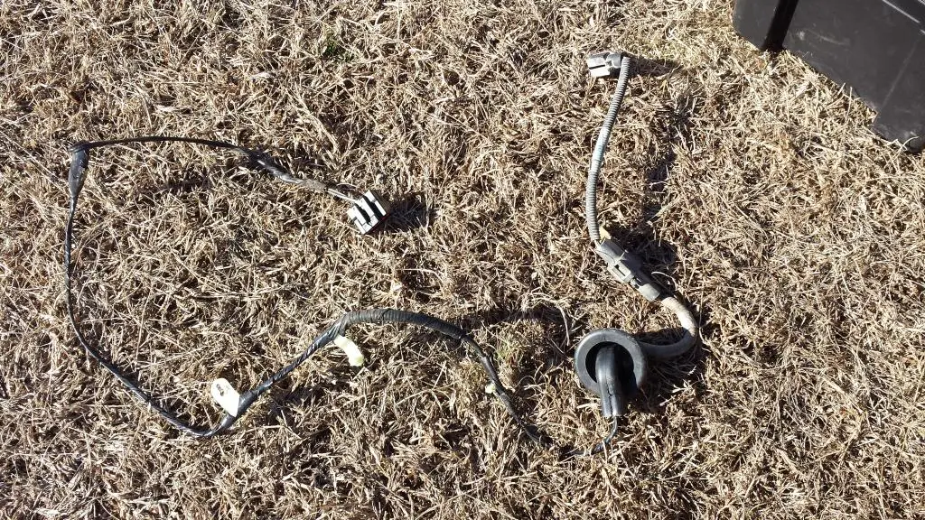

I spent a good 2 hours searching this issue, and no luck.
I recently swapped out my Electric 1354 for a Manual 1354.
What I am looking for is the wire colors to tap into to make the 4x4 and low range lights work on the dash.
I still need to get the plug from the junkyard, because I forgot that.
Thanks.
Why do you want the lights to work?
I bought the harness today from the junkyard.
My OCD is now solved.
