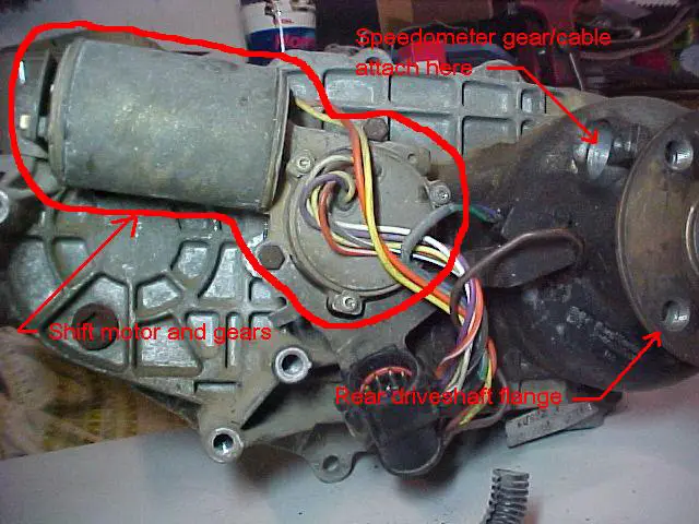

I recently bought a 92 Ford Explorer and cant get my 4x4 to disengage which is a problem cuz im getting ready to move to georgia and need it out of 4x4 and into 2hi that way i can drive it on the interstate. If you know anything please let me know.

One common complaint is the shift motor getting old and dirty. It can usually be "rebuilt." (IIRC, instructions are in this forum or the useful threads forum). In a pinch, you can take the shift motor off and use a pair of pliers to rotate the shaft to 2H.
I read the instructions in this forum and understand what to do but i cant seem to locate the transfer case on my explorer i know it should be bolted behind the transmission and that the drive shaft should too but the only thing i see looks way to small to be a transfer case.
It should be right behind the transmission with a skip plat covering most of it so if you see a plate going between the frame rails it's right above that.
Here is a pic of the shift motor on the back of the transfer case.
