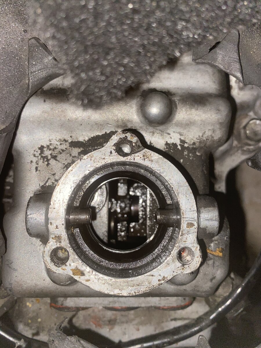

I recently did the clutch kit on my x I reinstalled everything at first it was shifting 1-4 just 5th gear (D) wasn’t going into gear I removed the shifter re installed it & now non of my gears go into gear? I checked the shifter cable looks fine. I checked the fluids and they look fine

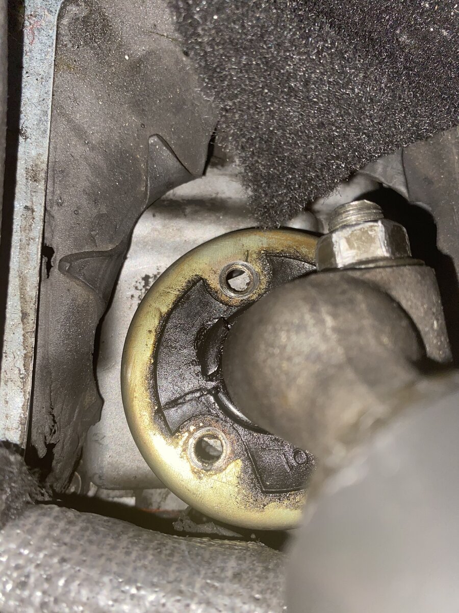

Second picture I had token off the torx screws. It’s been a minute since I logged on I’m sure there’s a post out there I looked for similar post I did get a little help & now I’m stuck
You did a clutch kit or a shifter bushing kit? Clutch kit means you dropped the transmission down and replaced the clutch. Shifter bushing kit would go along with what your pics show. There is no shifter cable on a manual trans.
Assuming you did the shifter bushing kit, you need to have the stick in neutral when you do it. Did you?

I did a clutch kit with the pilot bearing replacement I trapped the tranny yesterday & finally installed early in the morning.
Had no idea this where that small
So right when I pulled the shifter it agent into 4th gear I remember, I need to set it back to neutral but I tried the screwdriver method & had no luck aligning the tabs
*dropped the tranny
How do I get it back to neutral?
for lack of better words I did ****ed up
It gotta be stuck in a gear cuz I let go of the clutch and it dies
I figured it out. I got it into neutral & now it’s a little hard to change gears when my vehicle is on.
