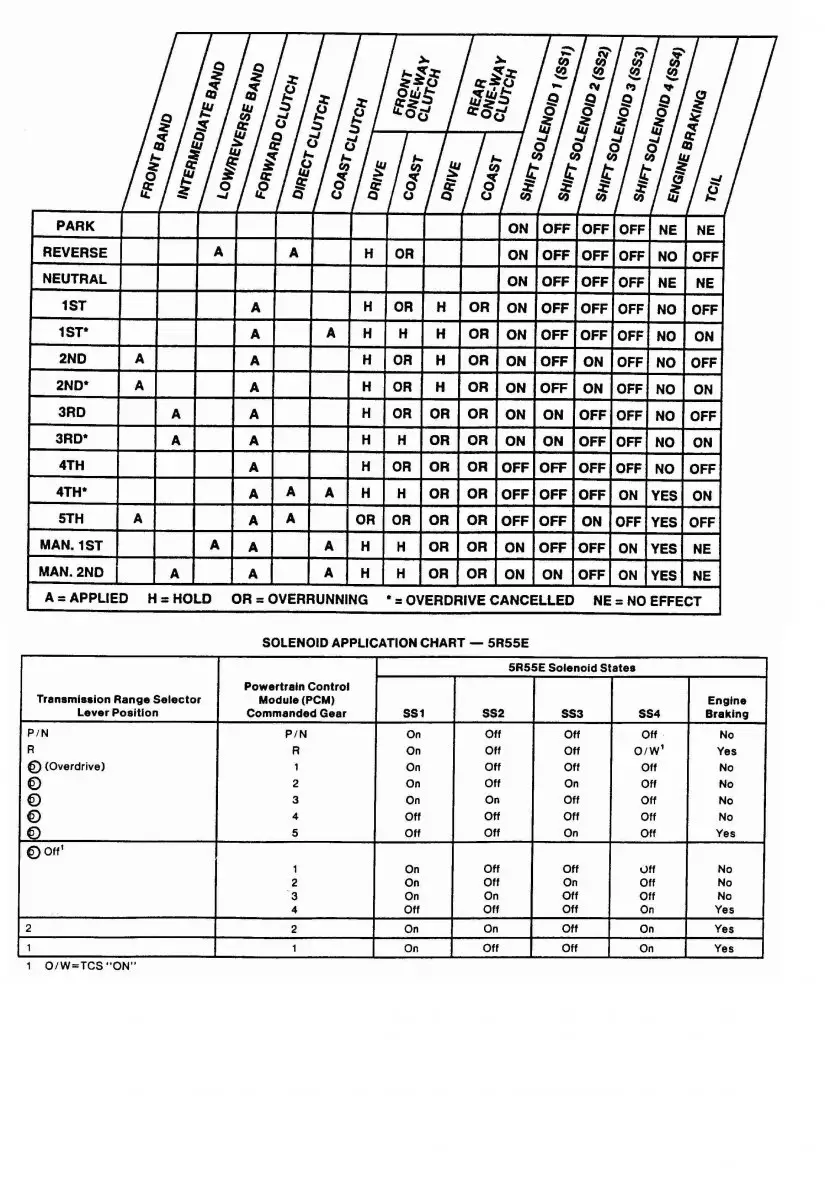

When i got the truck it had recently had thevtranny rebuilt. I did drop the pan and inspect wireing its all good. What do u think about this internal mechanicl clutch thangy this for mechanic was talking about. Does it control the shifting of 4th gear??
Maybe the mechanic said that no solenoid is activated in 4th gear?
I am not so firm with this electronical controlled tranny,
but looking on this chart the SS1-4 solenoid are responseable for the gears.
