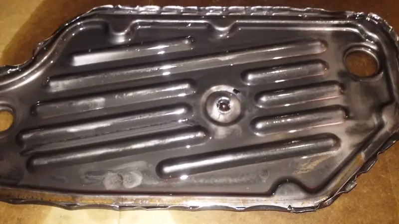

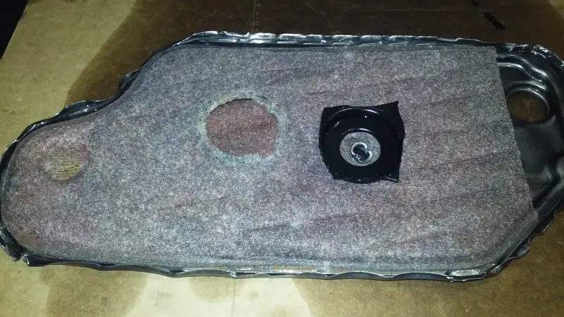

Upon further review the filter needs to be unfolded to see debris but I still don’t think it’s that bad

The pan looks just like mine did ! Mint
The filter did its job filtered out the big chunks
Now its time to add a inline filter !
A good one!!
