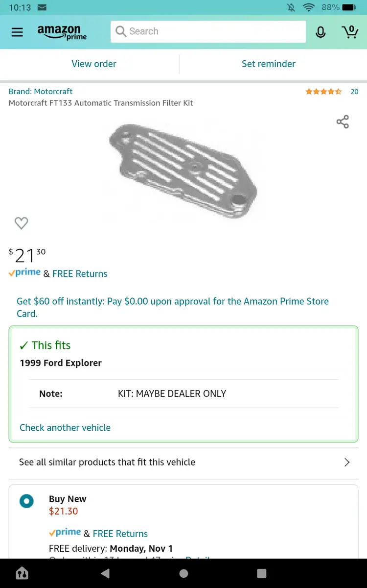

Kudos for opening up that filter and having a look inside. What brand filter is that?

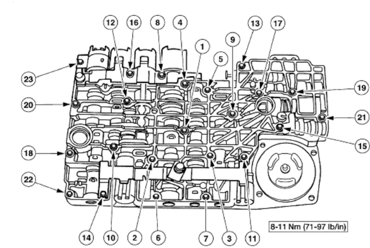

What torque should the vale body bolts be ?
sure
