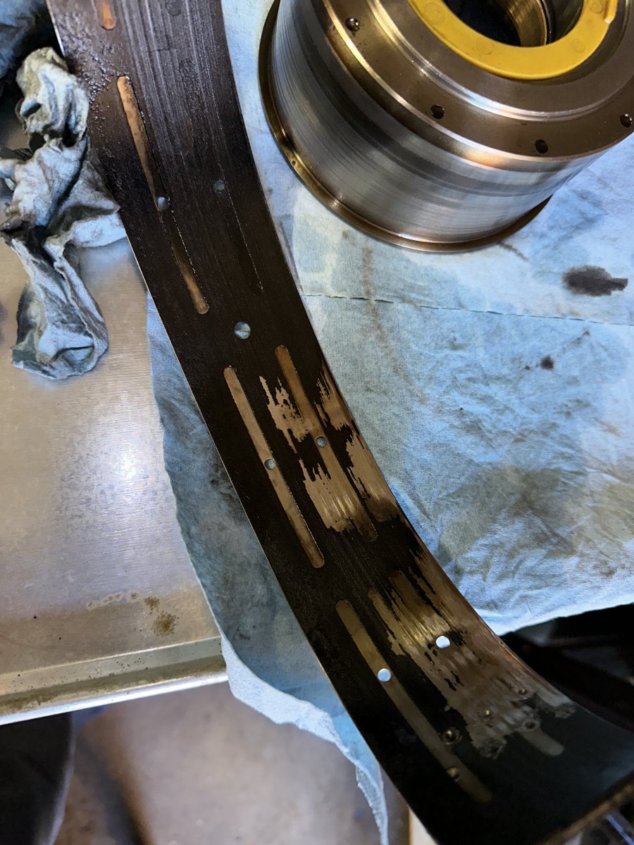

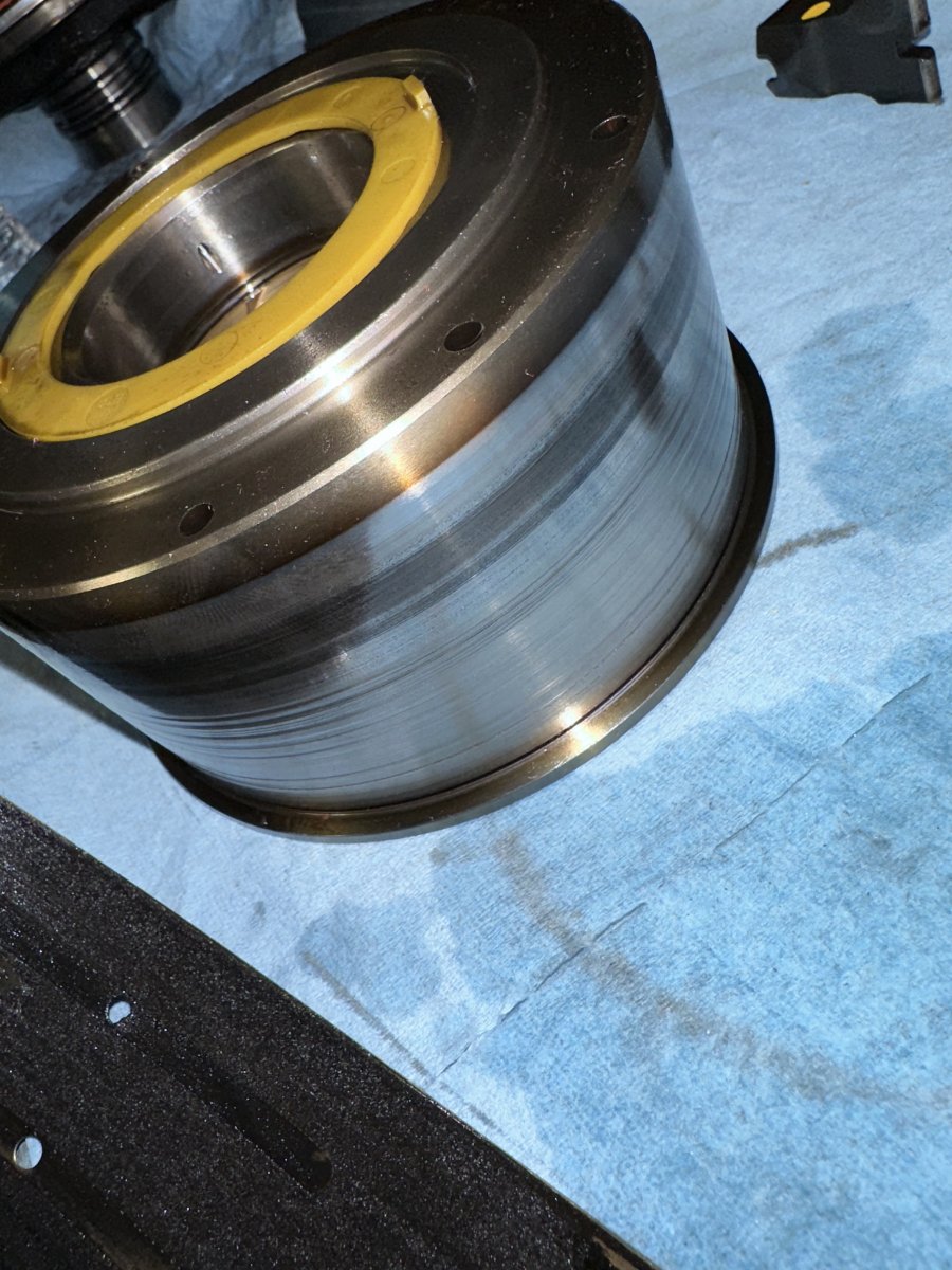

Should this over drive drum be replaced or can it be sanded with 180grit sandpaper or scuffed up a bit, it’s lightly scored
Yes replace the drum, I would think it will wear out a new band prematurely.
