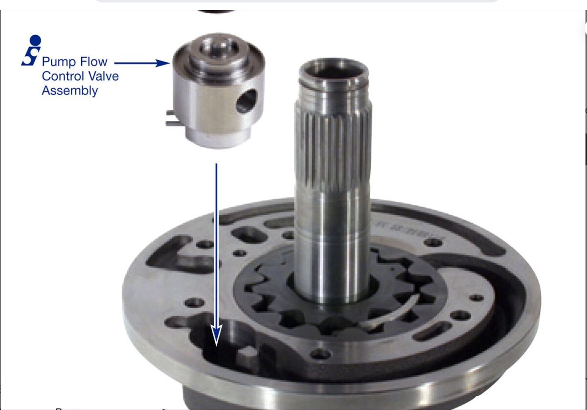

These units have a high failure rate on the flow control valve. About the only way to diagnose is to put a pressure gauge on transmission and to monitor line pressure. The valve is located inside the pump which requires transmission removal and disassembly.

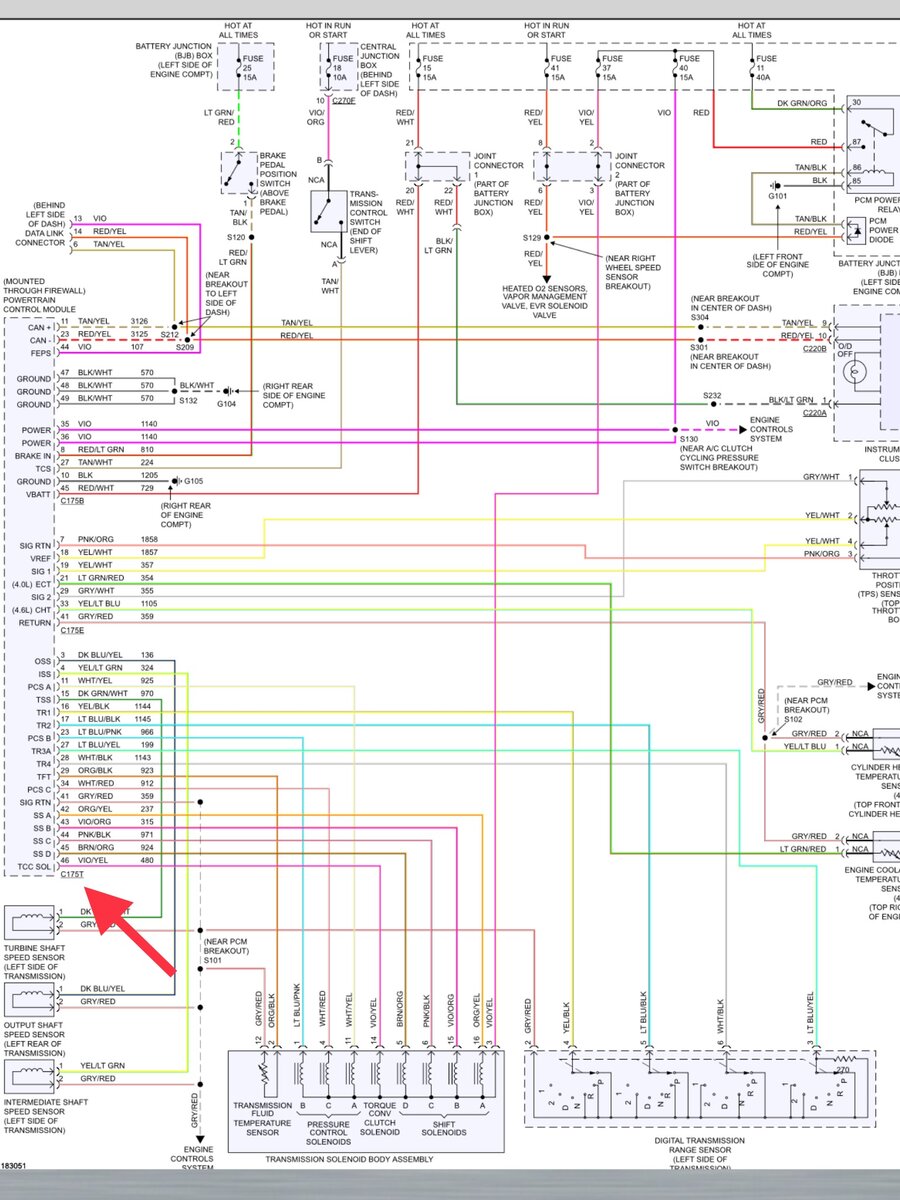

What do you think about solenoids? They also control pressure for multiple purposes. I read somewhere how to test the solenoids but can not find it again. Thanks to all for the input. Will dig a little more.
Very well could be solenoid pack. When you do the resistance check remember they may check good electrically but still not function mechanically. Here are some diagrams that may help. Trans temp sensor will not play a part in the testing.
Very well could be solenoid pack. When you do the resistance check remember they may check good electrically but still not function mechanically. Here are some diagrams that may help. Trans temp sensor will not play a part in the testing.View attachment 318367View attachment 318370View attachment 318371
Awsome . Thank you. Will perform these tests and go from there. If it is a solenoid, I suspect it is sticking and needing cleaned but ohm test needs done as well.Thanks again for info..
