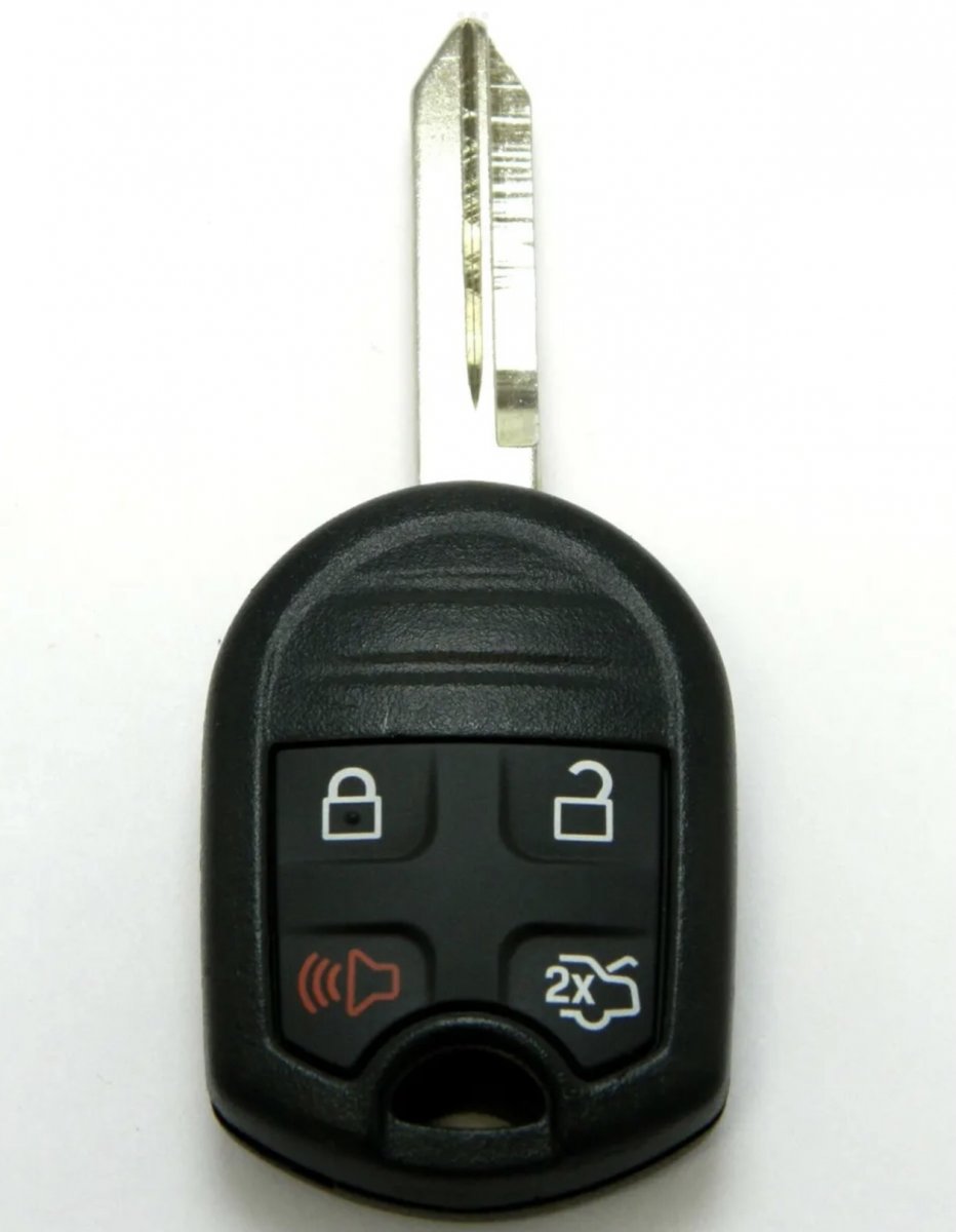

Hey everyone
My current key is kinda roughed up and broken so i want to get a brand new key when i went to the dealer they said the 4th gen keys are discontinued
Someone told me the 5th gen key the one that comes with the fob attached to it they said it would work on 4th gen explorer
Has anyone tried it before and does the keyless entry work too ?
One other question my car doesn’t have idk what it’s called but the number pad on the drivers door that locks and opens the car
Is there a way to add that functionality if i got the door panel from a junkyard
Or is there any other way to do it properly
Here’s the picture of the key I'm talking about
Thanks a lot in advance
The keys are still available. Maybe not from the dealer but they can easily be found on Amazon or ebay for very little money. The same goes for the key fobs. My advice is to have two keys programmed so that you can then program a third one yourself. This way if you lose a key, you can still program a new key to replace it.
