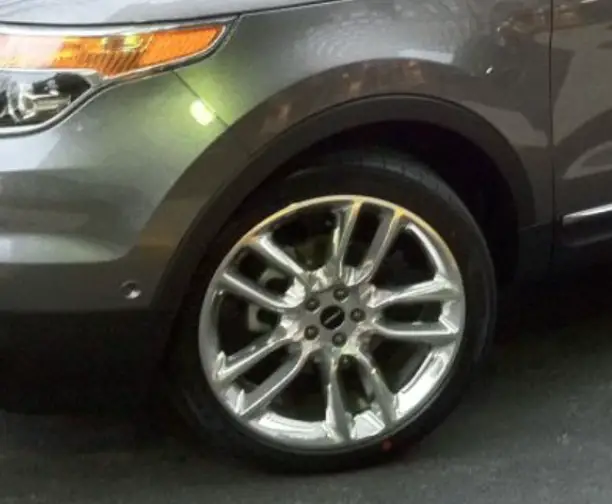

I have been considering possibly picking up a set of 5th gen chrome wheels, I think they're 20 inches. The bolt pattern and offset range are good, but it's there enough clearance for the wheel and tire? Has anybody done this swap?

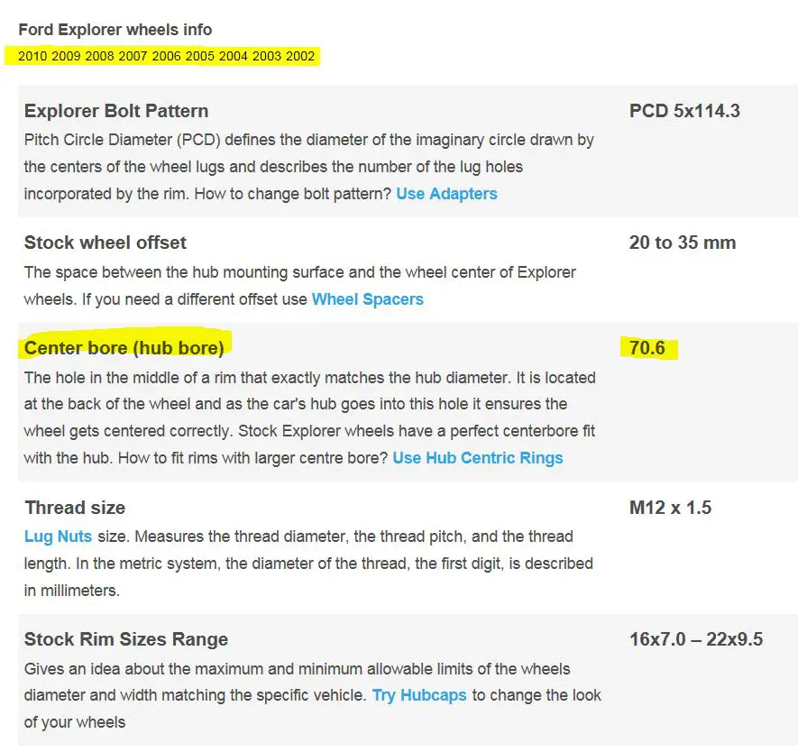

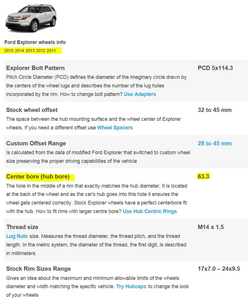

Your first issue will be the center bore (hub) diameter. 5th gen is 63.3mm, 3rd gen is 70.6mm.

http://autotk.com/wheels/ford/explorer/

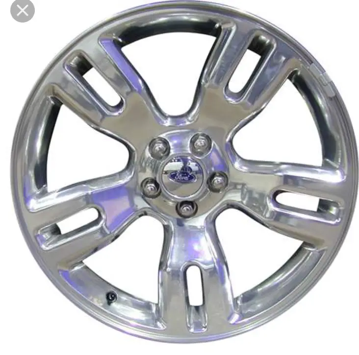

These are the ones I want:
Which resemble the 5th gens:
5th gens are built on the Taurus chassis aren't they? That would explain the smaller hub bore.

Yes, those are the ones I figured you were talking about. highly polished aluminum with clear coat- no actual chrome. They do resemble the 5th gen ones. Yes, the 5th gen Explorer is built on a shared platform with the Taurus (and others), that is also the same platform as the old Freestyle/Taurus X. This was in fact originally a Volvo car platform- believe it was the S90. Here is a pic of one of my 20" 4th gen rims, alongside an 18" chrome-clad 4th gen and a 17" chrome-clad 3rd gen. The 20" has already been refinished in a Hyper Silver metallic color, that's why it looks somewhat different from your pic. The 20 inchers will be going on my vehicle in the summer. Currently I have 18" 08 Sport Trac (refinished) rims on it- the ones in the 2nd pic.

2011+ will not fit. The center bore for the hub is too small.
Had another thread going with same question. I was supposed to drive a hour this past weekend to pick up wheels and tires off 2016 explorer for my 2002 mountaineer but couldn't go since I'm not sure they will fit. Even reading all posts here still not sure that they will fit.
Won't fit. Have a look at the screen captures that I posted above. In 2011, the Explorer switched to a unibody platform, essentially a car-based platform and switched to smaller hubs. 2011+ rims will not fit over the hubs on our vehicles. You are better off looking at 4th gen Explorer rims 06-10, if you want to go to an 18 or 20" rim. I've actually shown photos of 4th gen rims in my post above. I personally own sets of all the wheels in my pics and they are a nice upgrade over 3rd gen rims. I don't particularly recommend the 3rd gen/early 4th gen 17" chrome Limited rim due to issues with the chrome- that's the rim on the far right in my above pic.
