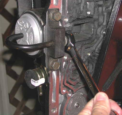

Thanks for the help and pics. Gonna show em a picture of the tool and see what they think.
Well----it's fixed---I hope. The poor guy was so mad he could barely talk. They screwed with that snap ring for almost 4 hours. There was maybe 2 inches to work in and was a ***** of a job. He wanted 150------what he stated in the beginning. I eneded up giving him 200 for 4 hours honest work on the truck. After the cap came out it took maybe ten minute to replace the cap and ring.
PS---I stopped at one other tranny place just before taking it back to the guys that did the job----they said the tranny had to be dropped in order to get the cap out. The quoted 350 plus tax.I feel sorry for people who know little about their cars because they must be getting gouged big time in this town.
