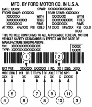

Transmission and Axle Codes:
http://www.explorerforum.com/ntrprize/Axle.htm
This code can be found in the sticker on the driver's side door, under the "AXLE" section (see image below, number 9).
And yes, it is 31 spline - all Explorer 8.8 axles are 31 spline.
Old post I know but in search this is as close as I got to what I want to know, which is - what does it ALL MEAN???????, as in the meaning of each individual code :scratch: :australia
I don't mean just axle codes but all of them on the door sticker, thanks for the quick answer though
Although not specific to your vehicle, this should explain the sticker codes.
Dead Link Removed
Thanks, that's exactly what I was after :thumbsup: :D
