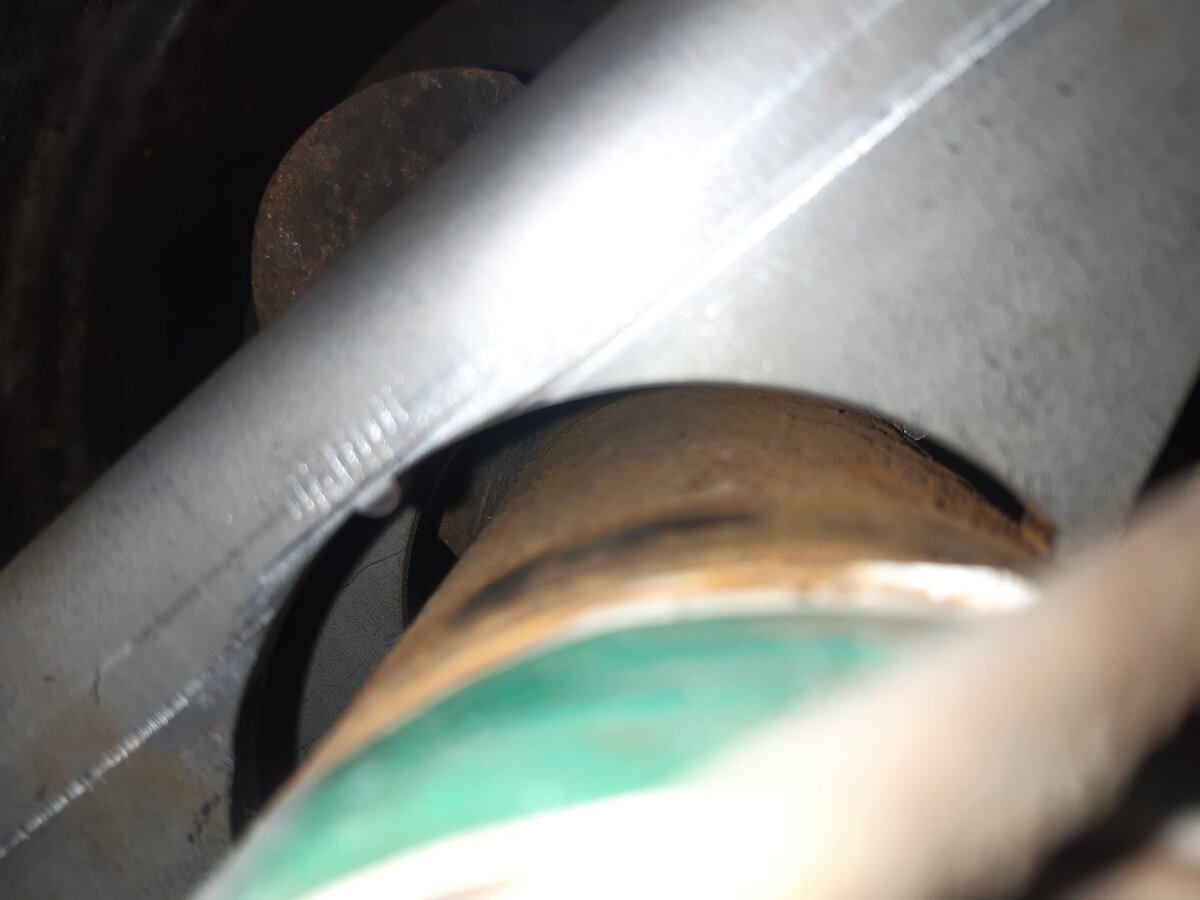

My back drum brakes decided to have a bunch of fasteners fail and ruin the drum so instead of putting money into that I decided I would grab the 8.8 disc brake axle out of my parts explorer. I ordered the ruff stuff mounts off Amazon and they came in. When I went to set the mounts on the axle there are some small tabs (I assume to space it out when welding) that don't allow the mount to go down all the way. Also when I tryed to put the mount against the explorer leaf spring the hole was too small for the bolt. Did anyone else run into this problem? I can easily grind down the tabs and drill out the hole but was curious what others thought.
Also I plan to keep the block in there, any idea if the centering pin on that is smaller and will fit in the mounting hole
here's the link to the kit I ordered, it is for the 31 spline not 28.
