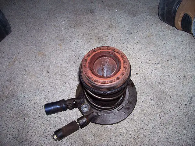

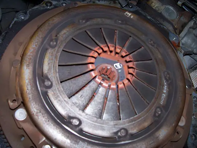

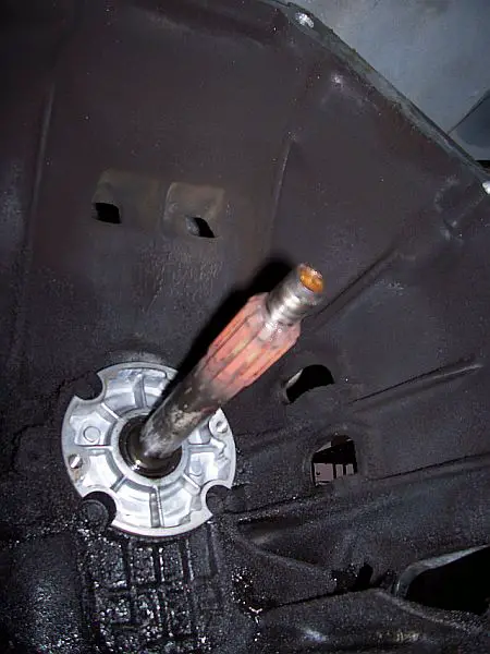

Well, the comealong did the job. :thumbsup:
Nothing looks visibly broken or bad, to my eye. Except I don't know why everything is coated in a brick red color? Any ideas what that is? (see pics)
The plan was, to replace the slave, because I had major problems getting it in gear. I may replace the clutch too, we'll see what it looks like tomorrow. If there's a decent amount of meat on it, and nothing else is wrong with it, I'll probably leave it alone.
Thoughts? ;)

The brick red is probably the remains of the clutch material.
It's open, replace the clutch and pilot bearing, and have the flywheel re-surfaced. Nothing like buttoning it back up to have something else fail..
