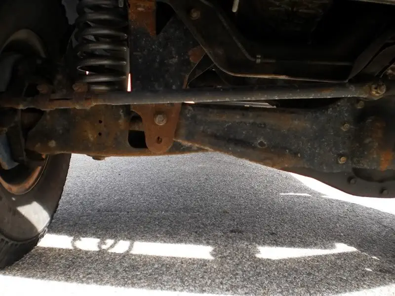

Drop pitman looks to be stock.I dont know much about lifts, so im trying to learn as i go.Here is a few pictures of the front end.

Those are 4-6in skyjacker drop brackets, move the ttb arm pivot bolt down a notch on the front to the bottom hole for 6 inch coils.

Those do not look like skyjacker brackets at all, more like superlift 5.5" And if you're looking for a whole kit I'm stripping down my 1st gen soon. You may want to call up superlift for the 5.5" coils and move the pivot point down like said before. And I would suggest a different pitman arm to level the steering...
Yeah those are Superlift brackets, not Skyjacker.
