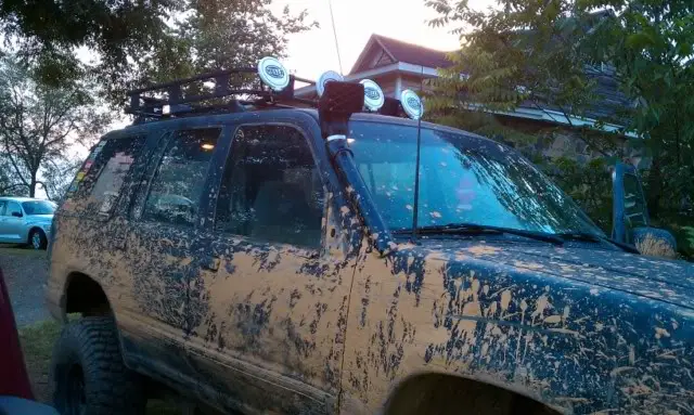

You can't bypass the sensor.. but plenty of members built their own snorkel setups using PVC pipe from the hardware store (and retaining the MAF). Search on Snorkel and you'll get hits such as:
1st Gen Snorkel setup
picture.php
ya that cone filter thing is kind of cool but i was thinking more along the lines of a snorkle so next time im in 4 feet of water i dont drown my engine out. is it possible to bypass the elect sensor thing to do this?
Like this?:D
