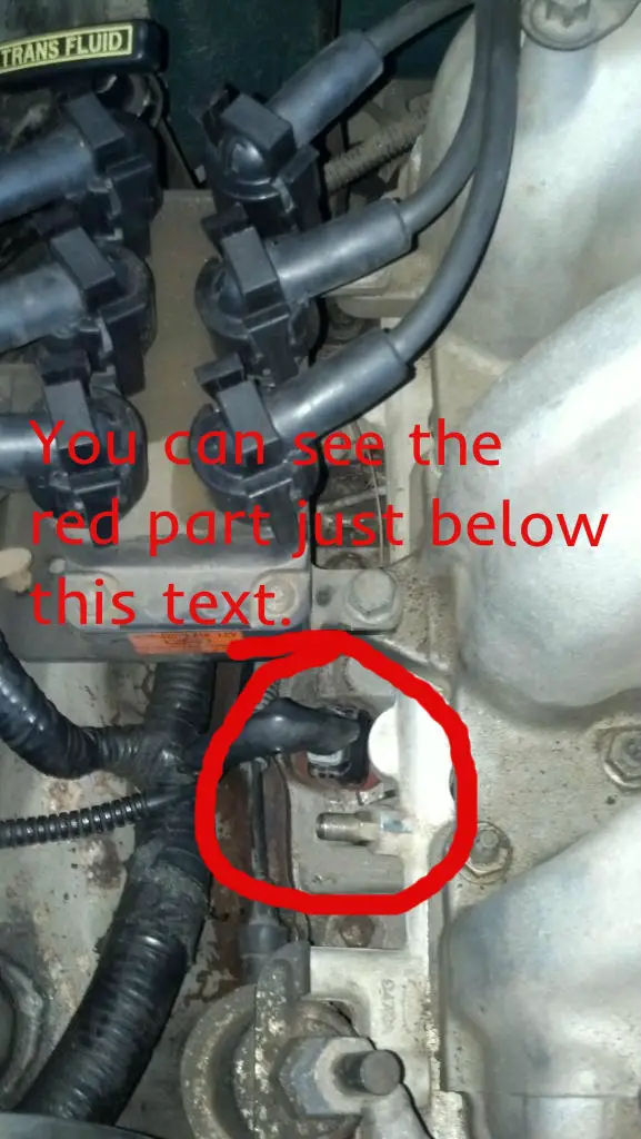

ok, here's the deal. I'm new, and I'm a woman who is very vehical ignorant. I have a '93 Ford Explorer with a new fuel pump and new/rebuilt computer. When I can get the vehical to turn over, it runs great. However, when I can't get it to turn over, there is a hissing sound near the "power relay?" just to the right of my sparkplugs. There is a red component that this power piece plugs in to. (I apologize...I work on computers not cars....) It does not have a tight fit, and I'm wondering if this is causing the fuel pump to keep the vehical from starting. I'mn not sure of the best way to add some pictures of the part I'm talking about.
Pic of part I'm talking about
im certainly no expert on your motor (would you mind clarifying what motor you have?) but that looks like a camshaft position sensor to me. I can't imagine how that would hiss.

When I turn the key to the on position, I can hear the hissing sound. If I turn the key all the way, the motor tries to turn over, but it makes a sound like your just don't have enough power to crank it. Basically it just werrrrrrrrrrrrrrs.
It doesn't sound like a short in a wire. I'll check to see about what motor I have.
