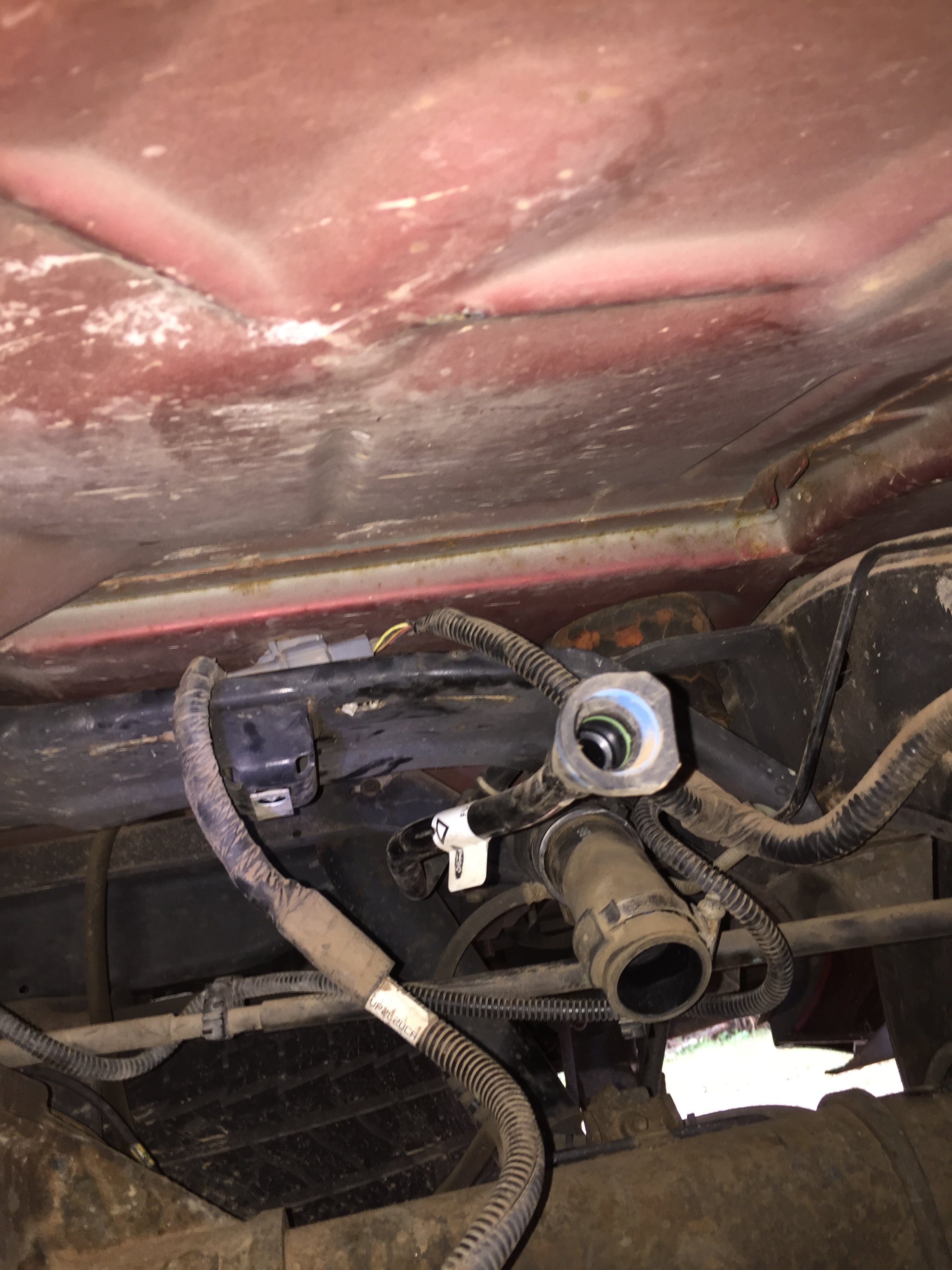

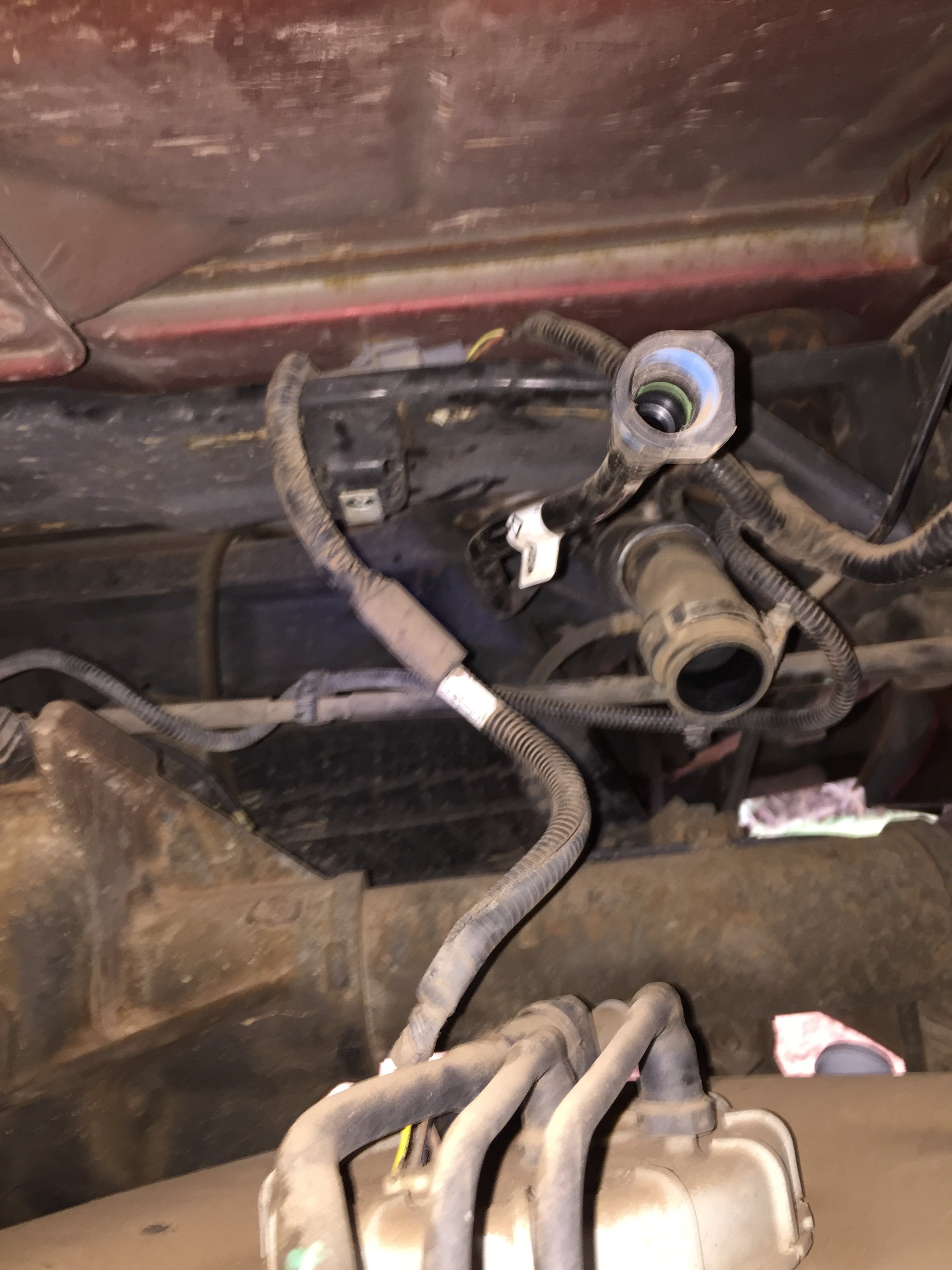

I have a 2002 Ford Explorer sport that needs a new fuel pump. I have tha fuel tank down but the electrical connector for the fuel pump seems to be between the body and the frame. Has anyone felt with this issue?
