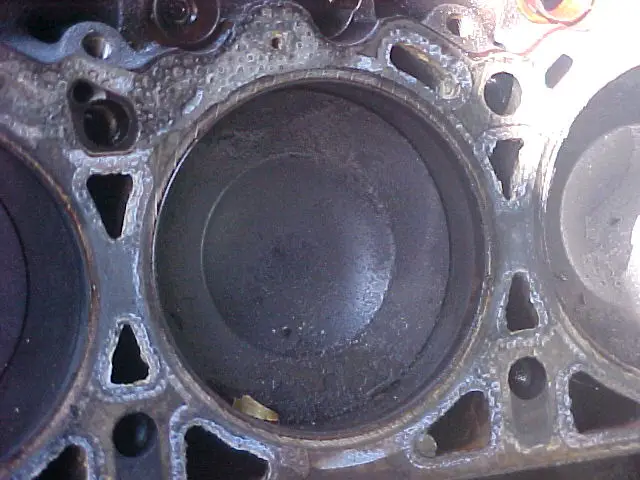

Is it pinging? this engine has a nasty habit of developing a ping. This has been discussed at great length here several times. Usually a result of running slightly lean due to a dirty MAF or a a vacuum leak trhough loose lower intake manifold bolts. Other possible causes, too.

Well, nothing I did fully removed the pinging or lugging up those steep hills until I cleaned things up while replacing the head gasket last year. Prior, cleaning the MAF did the most good, but not as well as this:
After a year, I still have a slight ping under heavy load, but nothing like it was, and power remains good, i.e. no lugging uphill (just wish the computer would down-shift the auto sooner).
