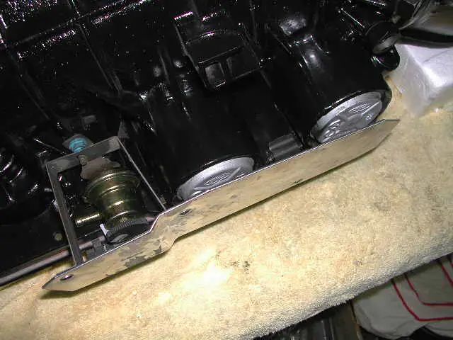

Thanks Glacier i never knew about the vacuum modulator which must be whats wrong with mine cause i always check for fluid loss and never find any. would you know where to find it?

It is the bronze looking thing in the pic under the blue bolt. It is on the passenger side of the trannie... follow the vacuum hose....

Shouldn't have to do either. It is in a tight spot... you may have to remove the heat shield to get it out (will have to take off the top bolt in any event since it holds the modulator clamp too)

The vacuum modulator consists of 4 parts. The actual diaphragm unit (the diaphragm can tear allowing ATF to be sucked up into the engine. A short "rod", the actual throttle valve, and a small return spring (in this pic I have plaved it on the new version. The only difference here is the one I am using is adjustable. Here's the old and the new, disassembled on the bench, side by side.
Those are the parts all right, but what you can't see is inside the factory sealed vacuum modulator unit on the left (which contains the diaphragm). I took an old one and pulled the seam apart and shot some pictures if anybody wants to see the inside "guts" of the modulator. It is pretty simple...two case halves, a diaphragm, and a spring. The adjustable one has another part that regulates how much vacuum is needed, but it is only one or two additional parts (I don't have a picture of those parts).
