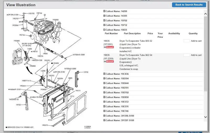

I'm still researching, however, I came across two valuable web sites:
http://www.m-m-s.com/ACKits_Public/ - unfortunately, cannot find info on complete "kits."
http://www.fordparts.com/ - duh, good place to view fiche images and verify part numbers.
Ironically, Amazon typically has the lowest prices, and most parts are eligible for Prime Shipping (two day service and I'm a Prime member).
