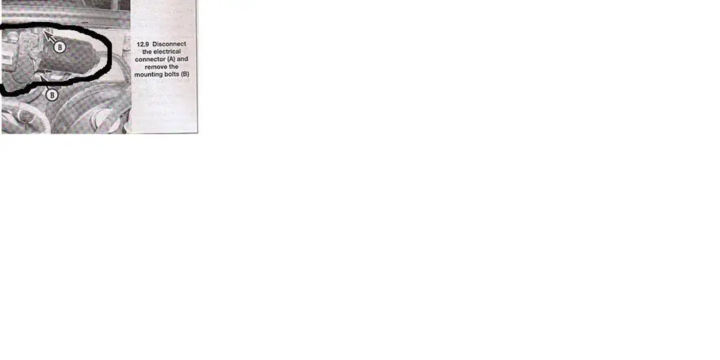

its under the hood, mounted on the firwall right behind you brakes master cylinder. i have a pic for ya if i could find out how to put it up on site.
Troy
sorry bout the quality its straight from the haynes manual... hope it helps though :)
if u want a better pic i can get ya one probably. u will most likely (99.9% sure) have to take the wiper linkage off first tho, since they are on the wiper motor shaft. take your cowl off. to do this u remove the drivers side wiper arm, then take the one screw holding the cowl on out. in the slot at end of the cowl almost in middle of the hood. then pry it off carefully. then inside you will see the linkage on the end of the shaft there is a clippy thing kinda like a snap ring cotter key lol. anyway it pulls off - i used a screw driver to help pry it. then slide each arm off. good luck
