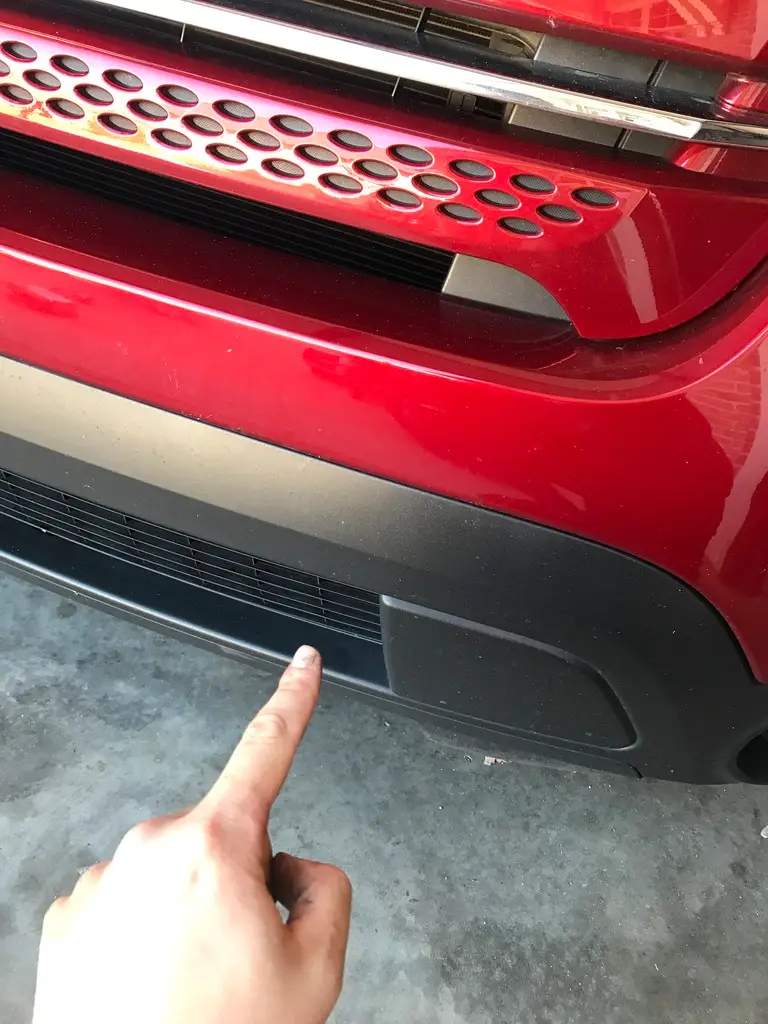

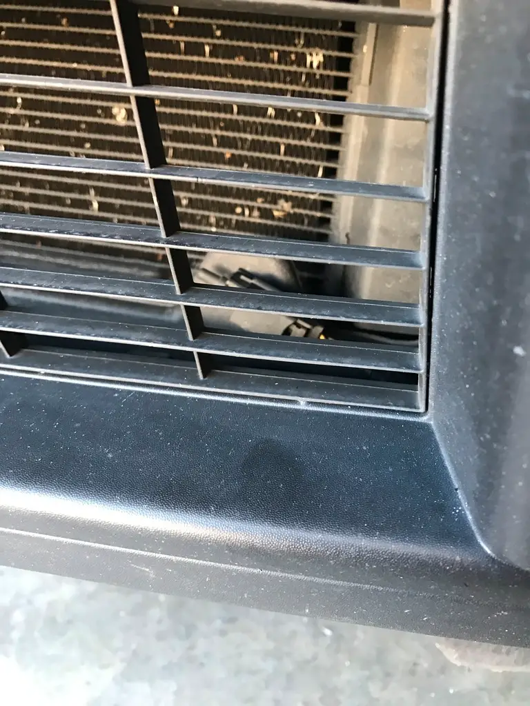

Here is the location:
That was incredibly helpful, I know others will really appreciate the pictures as well. After taking a look at the wiring myself, I saw it was frayed and almost cut in two so without having better knowledge of splicing/repairing wiring, I took it to the Ford Dealership and $240 later, they replaced the bad wiring and sensor. Everything is working great now and I'm happy with the price I paid to ensure it was done correctly.
