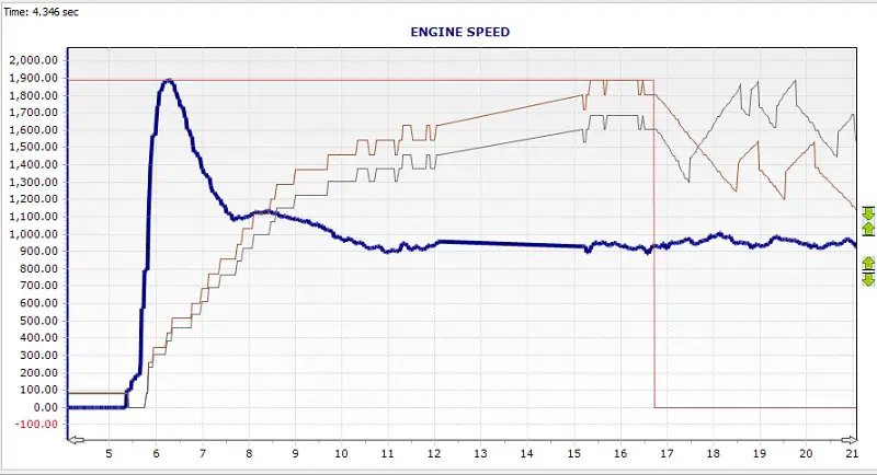

Apparently the PCM monitors the O2 sensor outputs when in open loop. I don't remember if the PCM outputs the O2 sensor voltages when in open loop but they would not be accurate immediately after engine start or at WOT. The O2 sensor heaters greatly shorten the time to make the sensor output reliable. My PCM enters closed loop about 20 or 30 seconds after a cold start but fuel trims are available (but inaccurate) almost immediately after engine start.
The plot below shows the rpm, STFTs, and open loop flag for a cold start of one of my first self tunes probably with no learned values stored in the PCM.
As you can see STFTs were being computed and available on the bus one half second after engine start. The PCM switched from open to closed loop at 16.7 secs (only 12 seconds after engine warm start).
