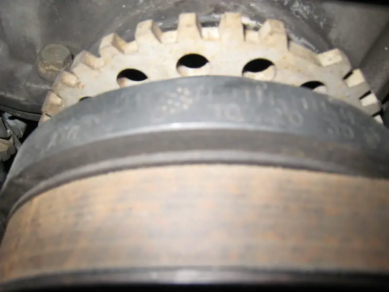

Checked the spark: OK Checked the compression in one cylinder: OK, disconnected the battery to zero the computer, no change. It cranks and fires weekly, coughing with light backfires as if it's completely out of time. Below is a picture of the trigger wheel. Does anyone know if the missing tooth is in the right place relative to the harmonic balancer? Is there any way it could have rotated and thrown the timing off?

As it turns out the harmonic balancer was to blame. The back side of it where the keyway is was shattered and it rotated about 90 degrees on the crankshaft. $80 to fix but months of being dead in the driveway.
