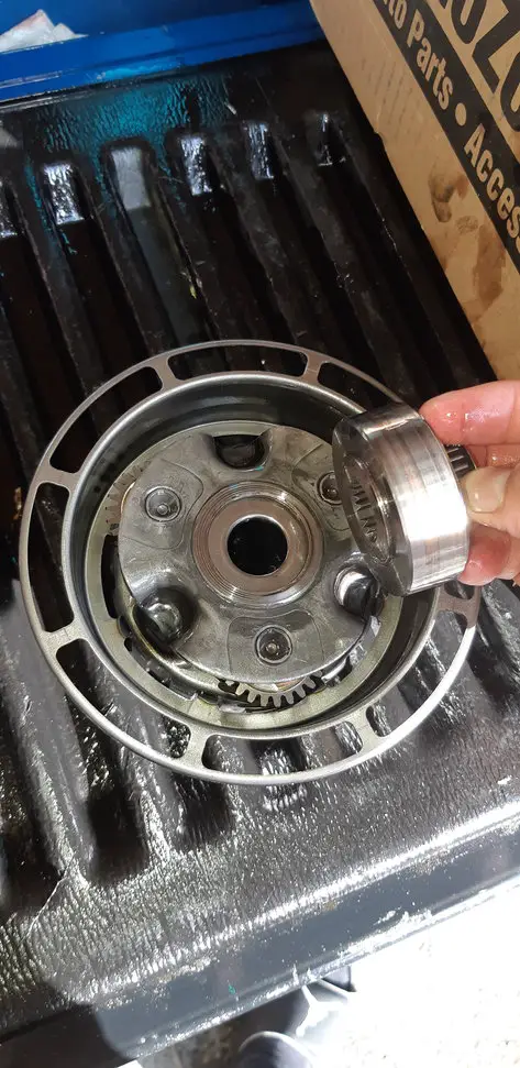

Its a very weak spot to begin with, after the first sprag failure there could have been wear or damage to the inner and outer races the sprag rides on and if they weren't replaced too it could cause a repeat failure.
Maybe the sprag is fine but the inner race broke off the planetary, seen this a few times.
These things can fail in a lot of different ways and most of them are due to part failure and not a heat issue. The most efficient way to run the cooler is to use the one in the radiator first then maybe a external one on the way back to the transmission.
