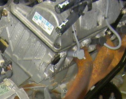

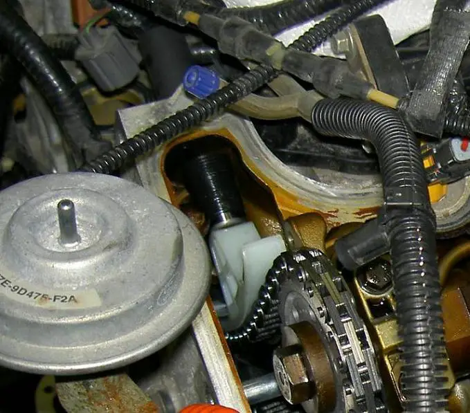

Below are the rear, and front tensioners. The rear part has a very thin head, it's at the top rear of the right head. They both go into the heads the same way, the heads could be swapped if necessary(they are identical). The front unit sticks out quite a bit, which is why the intake has to come off to remove it.

I assume the tensioner is the white plastic part with the spring behind it? If so is it fixed or held in place by the tension in the spring? My X has flared wheelarches as well, these look like they have to be removed before removing the inner fender, is this correct? Sorry to ask what may sound like basic questions but I've never had to do anything like this before.
The tensioners are the black steel part, they are self contained with a spring inside. The internal spring and oil pressure are how the chains are held tight.
The white plastic is part of the large chain cassette assembly. That plastic is what is prone to falling apart in the pre-02 models. If it begins to, then the symptom shows as noise, from the chain becoming more loose. You are hoping to keep high quality oil in the engine, and that the external tensioners are weak.
Don't remove the fender flares, they are also held on with lots of plastic clips that you can't see easily. Remove any screws that you need to for the inner fender liner though, they are easy to deal with.
I have a rear tensioner here at my desk, for a forum member friend in Australia. The rear tensioner part number is 7U3Z 6K254 A, it is about as long as your middle finger.
