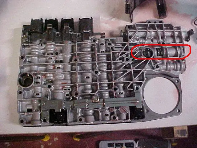

Here's a pic of the valve body as seen from the bottom (as you would see it after dropping the pan and removing the filter) - ignore the red mark:
Four on the driver's side and two on the other. There are only three types of solenoids: The "TCC inhibit" is shown at the top left, the next two over are "shift" valves, and then the "EPC" solenoid. The bottom two are "shift" valves as well. If I remember correctly, the one sown at the bottom left also is involved with the converter clutch, so I would definitely check that one out as well.
