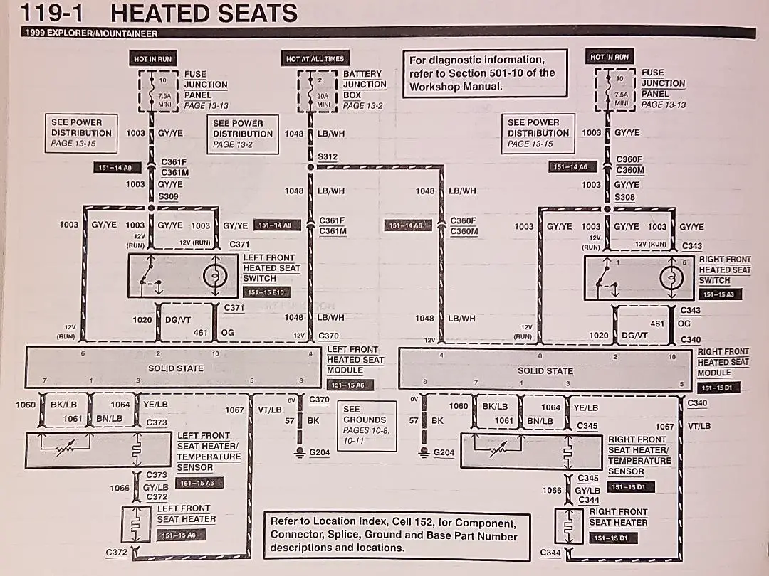

Does it have memory or heated seats? I don't know but there's some potential info here:
J_C, thanks for the reference. I updated my post to reflect (a) not memory and (b) not heated.
^ I saw that in my diagrams too, but it doesn't match his wire colors.

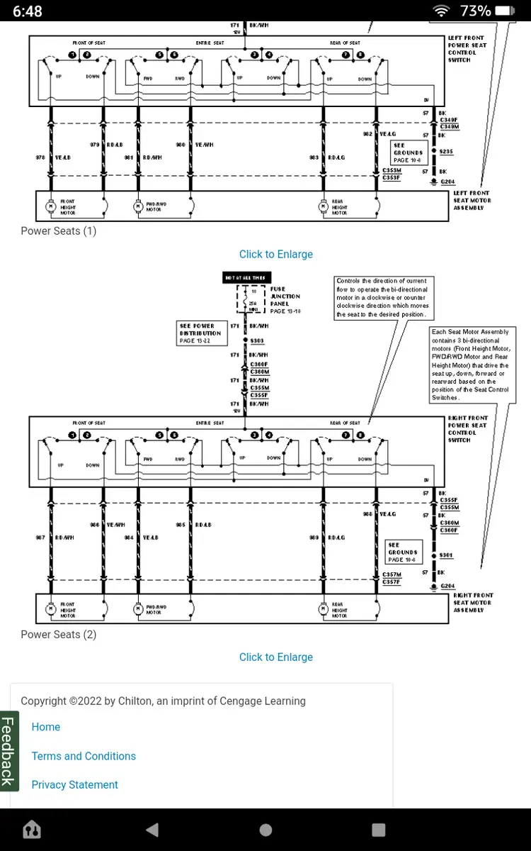

Using a 99 Ford Ex wiring manual:
Black - ground wire
Black/ white stripe (BK/WH) - 12 volt feed. Left and right power seats and power lumbar.
Grey/Yellow stripe (GY/YE) - 12 volt (run) to both heated seats.
Light/Blue (LB/WH) - constant 12 volt to both heated seats.
These are the only matching wire colors in the seat wiring diagrams.
See picture below.

Thank you! Problem solved! Just as you said above regarding the two wires that power the 3 motors on each seat.
The harness & plug evidently come wired for the heated seats (the GY/YE and LB/WH) even though my seats aren't heated.
