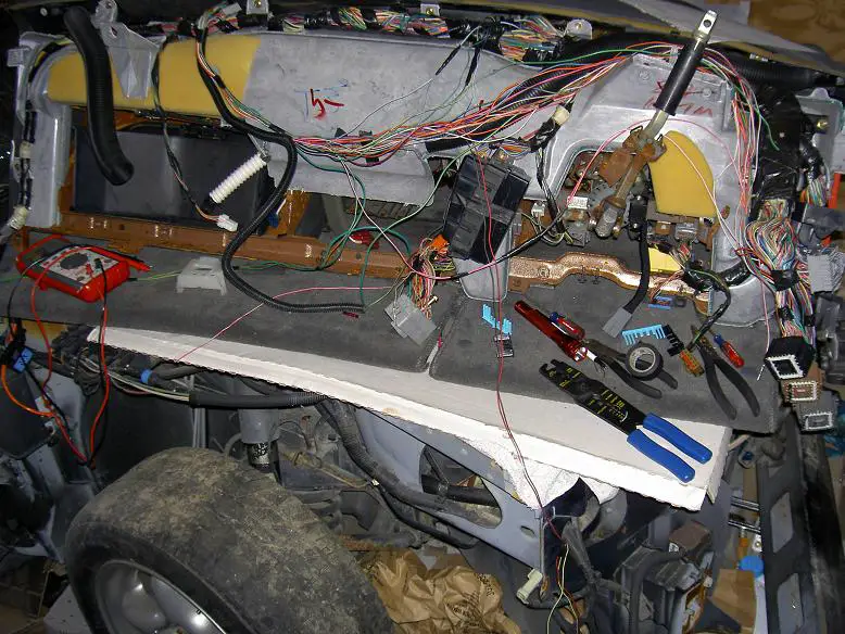

Welcome, and I have a good idea of what you have and want. I have a 99 Limited which I rebuilt completely, and I have seen every one of the ten vehicle harnesses out of the vehicle.The harness that you mention is the dash harness.
There are a ton of wires for the full radio options, plus the console options. It is extremely unlikely that you could add those and have it work properly. I am not using my 99 with it's console, it's a work truck for me, so I have that console connector tucked behind an ashtray. I had to cut and splice eight wires there to make my rear speakers function. Each wire is important, and they run all over the dash, the backside.
I would suggest two possibilities, first contact a few of the radio companies who make adapters to fit radios etc. There are some adapters that can help to add some features. My 98 Mountaineer had no changer, but a mid level radio like yours. A previous owner had an adapter harness installed behind the radio, so it connects the radio wiring to a Mach radio, and an OEM changer in the console. There are no markings on the adapter, but it may be the type which could help you. It wouldn't help with the rear seat controls, my truck did have those(wires) already.
Secondly you could go about swapping the whole dash harness, which is a big job. If the price was good enough, that would be a decent idea. Basically any options are dependant on the dash harness. If you went to find a dash harness, it would have to have all of the features needed, like steering wheel controls, the message center, etc. Good luck,
