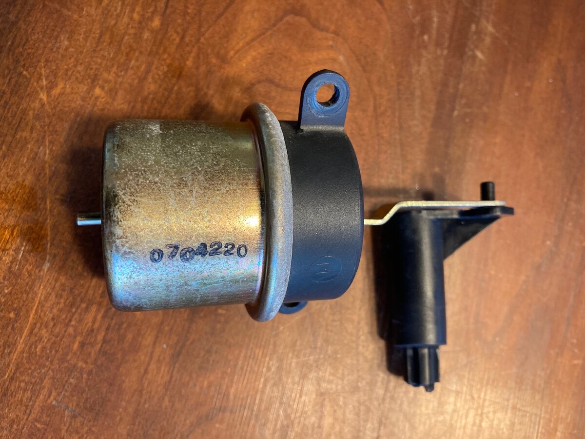

There are only two correct positions for the air recirc door and those are full open or full closed. The only positions on the dial that make the recirc door close are "off" (at the 12 o'clock) and max a/c. In any other position the door is open. It's a vacuum actuator, not electrical. The dial position causes the vacuum actuator to go either full up or full down which moves a crank-type arm that goes from the actuator to left upper side of the door. When the car is shut off, the vacuum actuator remains in the last position set on the dial which keeps the door either full closed or full open. From your video I can see that door is hanging where it's supposed to be (has not fallen over the fan intake) but is not connected to the actuator. I can also see that the actuator is not working IF the video shows you cycling through off, max A/C and the other positions. That arm coming out of the actuator should go up or down depending on what's selected. Check your vacuum line to the actuator and to the control panel. What is that zip tie attached to the actuator arm supposed to be doing? It looks like someone attempted to jury rig something to the door arm and it failed. Where that white zip ties is is where the end of the crank coming from the door is supposed to be. As the actuator goes up and down it moves the crank that moves the door. Your crank is not connected (thus your floppy door) AND your actuator does not appear to be going up and down.
Here's a picture of the actuator with the door crank arm in its correct place. You can see where the vacuum line attaches at the bottom. This crank is broken as many are. It's broken at the actuator side where there's supposed to be a piece plastic that help keep the crank attached to the actuator arm. I drilled a hole through that little piece going through actuator arm and pinned it place with a tiny cotter pin I made out of paper clip. You have a white zip tie going through the actuator arm where that little black plastic piece is supposed to be. The other end of that black plastic crank is supposed to clip into the left upper side of the door. It is broken too. The clip breaks. I glued it in place to the door with some sealant. It made it through winter working as it's supposed to.

There are only two correct positions for the air recirc door and those are full open or full closed. The only positions on the dial that make the recirc door close are "off" (at the 12 o'clock) and max a/c. In any other position the door is open. It's a vacuum actuator, not electrical. The dial position causes the vacuum actuator to go either full up or full down which moves a crank-type arm that goes from the actuator to left upper side of the door. When the car is shut off, the vacuum actuator remains in the last position set on the dial which keeps the door either full closed or full open. From your video I can see that door is hanging where it's supposed to be (has not fallen over the fan intake) but is not connected to the actuator. I can also see that the actuator is not working IF the video shows you cycling through off, max A/C and the other positions. That arm coming out of the actuator should go up or down depending on what's selected. Check your vacuum line to the actuator and to the control panel. What is that zip tie attached to the actuator arm supposed to be doing? It looks like someone attempted to jury rig something to the door arm and it failed. Where that white zip ties is is where the end of the crank coming from the door is supposed to be. As the actuator goes up and down it moves the crank that moves the door. Your crank is not connected (thus your floppy door) AND your actuator does not appear to be going up and down.View attachment 329156
I know this may not be clear. Your (black plastic) crank arm must still be connected to the door or the door would have fallen on the fan. However, your crank arm is not connected to the (metal) actuator arm. That's why your air recirc door is still hanging where it's supposed to be but it's hanging freely. If it was connected to the actuator it wouldn't be free. Someone tried to jury rig it with a zip tie, probably because the end of the black plastic crank arm where it connects to the actuator is broken. I don't know why your actuator arm isn't going up and down other than it's not getting vacuum. Those actuators are pretty reliable. You can pick up replacement pieces at a junkyard, but it's a lot of work to get at them.
