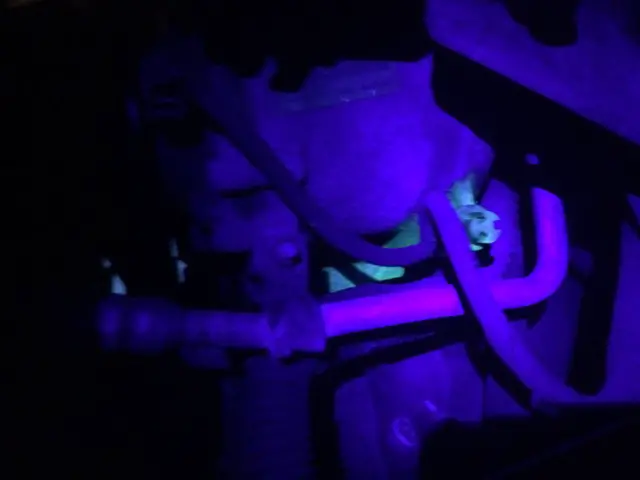

Just went out in the dark with the light and found signs of leaks on the top of the compressor and the bottom of the compressor near one of the electrical connectors.
picture of top
picture of bottom

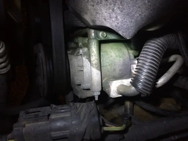

In daylight after I did start investigating the top of the compressor did look like there was condensation but now we know it is refrigerant.

It appears to be leaking out of the hose manifold to compressor seals and spraying all over the top of the compressor.
