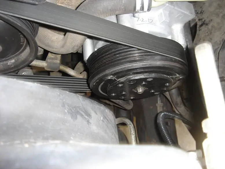

Just to make sure we are sure your compressor is on, Open the hood with the ac on and engine running look to see that the clutch is spinning and not stopped. Included photos 1. is spinning, 2. clutch is stopped.

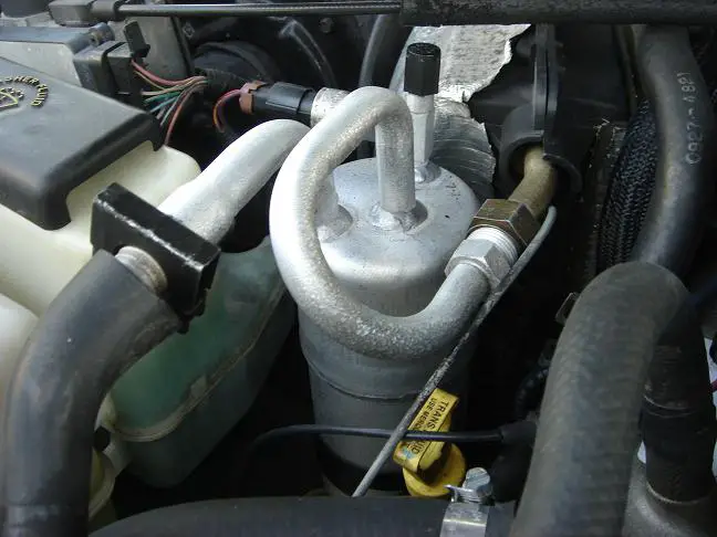

If clutch is working/spinning see if the accumulator is getting cold. My 3rd photo is showing condensation forming. If so then the issue is inside the cab somewhere. If not then the issue is somewhere in the closed system, maybe a clogged orifice tube.

Thanks! I can see with the A/C on my clutch looks like pic 2. The belt moves freely around the wheel and the wheel spins but the outside of the wheel does not spin like pic 1. So what does that mean? New A/C compressor or just a new clutch and do I need to open the system?

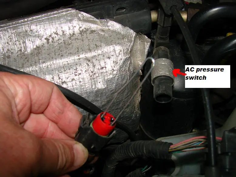

Try jumping the pressure switch (photo attached) The compressor clutch should engage. If so again see if the accumulator gets cold. If so then you may just be low on R134a. Fyi when checking the low pressure the clutch on the compressor needs to be running.

Thanks for all the help so far. I used the paper clip and I can now hear and see the compressor running! So from what you said I need to add freon because when I read it before the clutch was not engaged giving me a false reading in the green area on the dummy gauge. Guess I've always had a running a/c clutch when I've checked freon on my other rigs. So I will try filling it again and let you know what's going on. What does the psi need to be...45 or so??

I ran out of hours in the day to do this, I will do it tomorrow and let you know. Another thing I noticed...inside the a/c pressure switch connector I think one of the pins broke off. I need to take a look at that and let you know too.
Maybe the pressure is OK, but the switch is broken...
Fixed the pin in the switch. Read the pressure which was now low with the compressor on. Added freon and the ac is now ice cold! Thanks guys. Ill see if it leaks out or not but for now its finally working. This free rig I got is getting better all the time. Now I just have a dash light bulb to fix.

Took a while to get back to you all. I don't need the dye, as I can clearly see condensation form on the copper hose the runs under the accumulator into a box of some type. Is there a seal where the tubing meets that box?
any place that any of the A/C tubing connects together and is dis-connectable there will be a seal. most of them are o-rings and will most likely be nitrile IIRC.
if it is just condensation then it might not be a leak. you are going to get condensation on any of the low pressure lines as the refrigerant cools when expanded from the compressed state.
