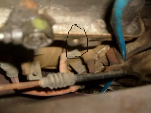

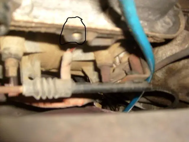

K the first pic is showing you a hole in the front driver side of the tranny, seem to be missing something. Beside it there is a blue air brake line a guy that owned it before me put on it, Its connected to a hard line. Now I tried my best to trace this line an it seems to go up by the fire wall an is held on the the bell housing of the training an does a u turn back towards the rear of the tranny. He has the blue air lone hooked to it an running up to the vacuum tree.. Could anyone tell me what this line is for an what I might be missing?
I don't believe it's for the vacuum modulator cause I was told that line is the hard line coming up on the passenger side of the motor an has a bracket holding it on the intake, then has a short rubber hose that connects to the vacuum tree.. Thanks in advanced for any help
Check the upper rear overfill connector. The hose might be connected to it. As for those extra holes, the side with the linkage has mounting holes for either a floor shift or a column shift. The opposite side has the hole to connect a heat shield.

Thanks BrooklynBay... But where is this overfill tank your speaking of? The blue hose there connects to the back of the vacuum tree on the intake, but like I said the hard line looks an feels like its the one that is braced on the bell housing an routed to the back of the tranny somewhere
There is no overfill tank. There is a fitting on the upper rear of the transmission which is sometimes connected to a length of hose looped around the top of the transmission.
K, so where does it hook up on the other end or does it not get hooked up? Say I had problem with tanny fluid in the air intake, if that is a overfill line that would explain why I had tranny fluid in there then right? Or wrong lol? Just thinking this cause if it is the over file line he put the blue line on it an ran it to the intake which sucked in tranny fluid if it was over filled..
That overfill line shouldn't go into the intake. It will draw fluid into the intake, and appear as if the modulator is bad when it isn't. This is the first time I've heard of anybody connecting this line into the intake.

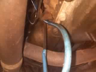

LOL wow... Well I changed the modulator a few days ago, with a new on that has the lil adjusting screw on the end.. Now it is not wanting to shift into 4th gear let alone 3rd... takes off fine an shifts in 2nd around 25 depending how much your on the gas pedal... But back on that line it comes from the top of the tranny an is coming down the driver side of the tranny an is pointing straight down, As you can see from the pic that's where he put the blue air brake line on it an ran it to the vacuum tree... so where does the overfill line supposed to go to then?

Did you remember to install the pin when you replaced the modulator? As previously stated, the other end of the overfill hose doesn't go anywhere. It's just looped around.[/QUOTE
Yes I put the pin back in with a little bit of vasolene on the end. An so I'm understanding you correct, the end of the line that is coming down underneath the vehicle an on the driver side of the tranny that is pointing straight to the ground doesn't get hooked up?
You are correct. It is just left open. The previous design of the A4LD case didn't even have a fitting for an overfill hose. It just had a little pressed on vent cover which kept dirt from getting into it.
