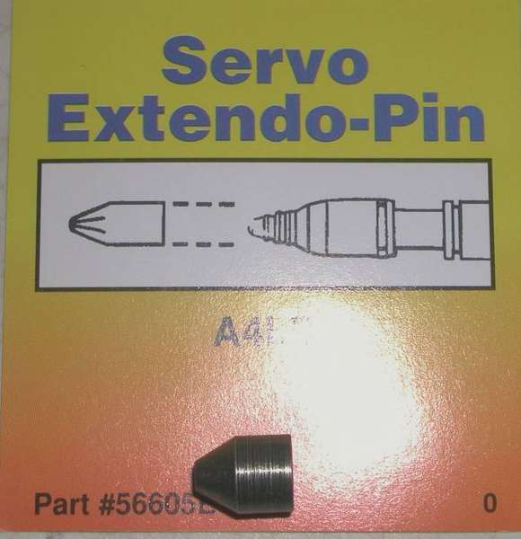

One issue that plagues owners of Explorers with the A4LD is the "put in gear and wait" problem. This happens in reverse - and sometimes 1st, when it happens..... because the LOW band is used for both gears and the delay is in filling the servo to engage the band.
It was commonly thought the problem was due to a leak.... and it often is... but sometimes, even when you replace the seals on the servo there is still a delay. This has been puzzling. I have wondered if the wear on the band could mean that this non-adjustable set up might need a longer rod...
I rebuilt a VB for someone last summer and sent new seals for this servo and they reported they still had a delay.
Someone has developed a product to handle this problem. It extends the servo pin on the A4LD by .200, sufficient they say to solve this problem.
Here is the solution. costs about $3.
You can grind it if it is too long. A nice tool in the arsenal.
