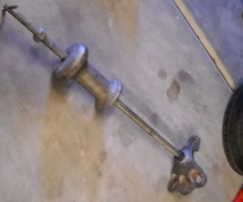

I returned home from the auto parts store with a slide hammer and hub puller adapter from O'Reillys. Hello old friend. The hub puller did not quite fit the Explorers 5 bolt pattern. I had to clearance some of the casting in order to snug it up. After 5 or so firm wacks, the hub was still firmly set. Took another 10 wacks or so before it began to gap from the knuckle. Another 10 before it was free. This would have never gone with the engineers hammer I was using.
