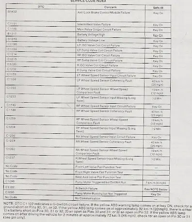

Hey everyone,
I finally pulled an ABS code after having the light on for like 2 years.
A mechanic told me a year ago that it was a failure in the front left hub, and the hub had to be replaced.
Well, the hub is fine so i didn't do it.
Anyway, I finally pulled the code B1483 which is a "Brake Switch Circuit Input Failure."
Does anyone have any idea what exactly it is and how to fix it? I'd like my ABS back. I ended up sideways this winter cause of it.
Thanks.
