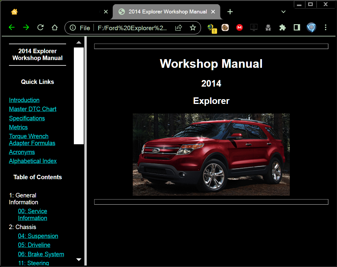

What exactly are you seeing that means "shows damaged or broken"? If I load Service Manual.htm in a browser it looks like this except I have a black background because the browser is in dark mode. There's nothing elaborate about this manual, is all standard HTML and JPG image files, not even any scripting that I've noticed. I don't know what more I can suggest, I just downloaded it again from this google drive link (same I provided previously) and this copy of it is working fine:

Thank you, I've tried chrome Firefox and edge , all give me the same result. However I haven't tried it on my computer only the phone. I will try to open it on my PC tonight I got it uploaded to Google drive maybe it's not compatible on Mobile
Yeah apparently you can't browse local HTML files on your phone. I found this then stopped researching it.
