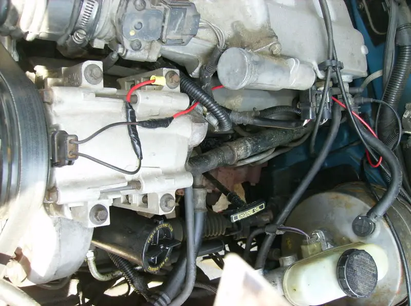

Here are some pictures..

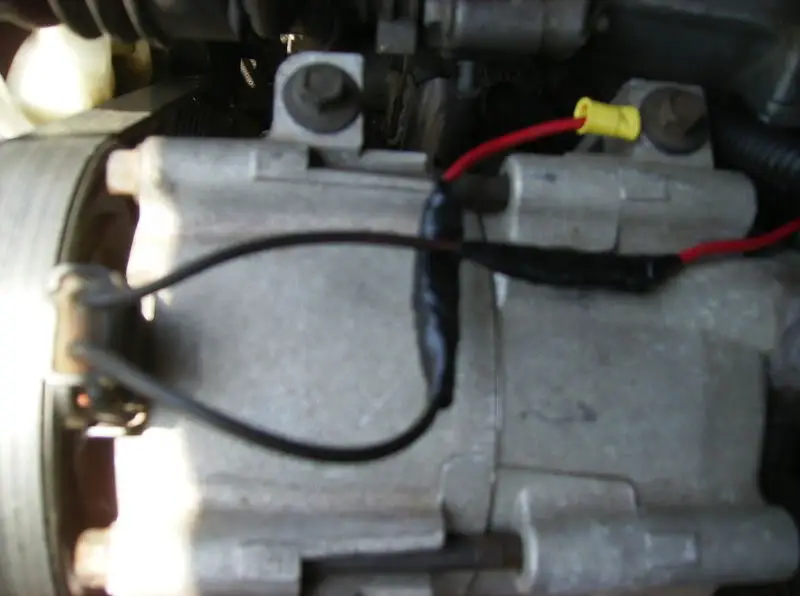

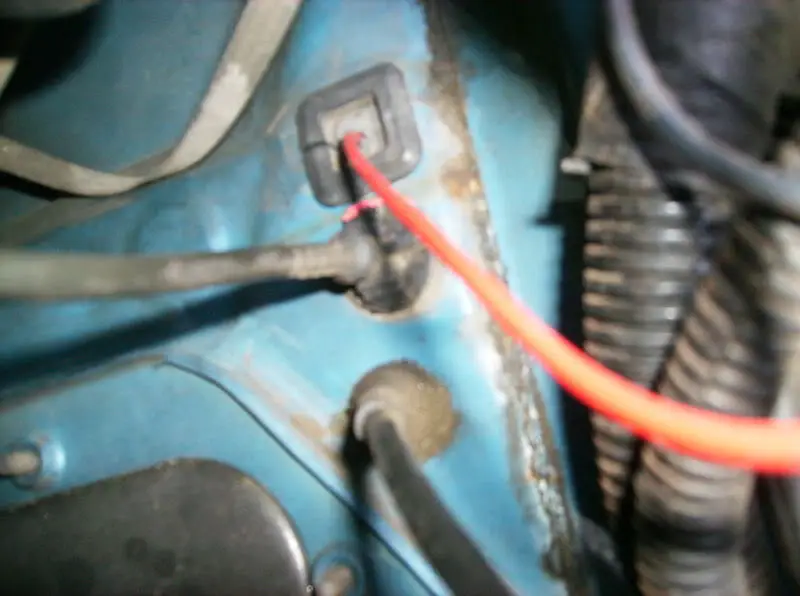

At the compressor: one wire goes to a mounting bolt for ground, one wire goes into the firewall.

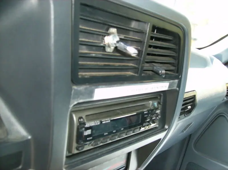

Then run the wire to a switch. The location is up to you. I installed mine in the faux vent where they usualy have the transfer case switch on 4x4 models. Donet forget this very important step: put a note on the dash to remind yourself to shut the ac off when the car is stopped otherwise it will drain your battery.

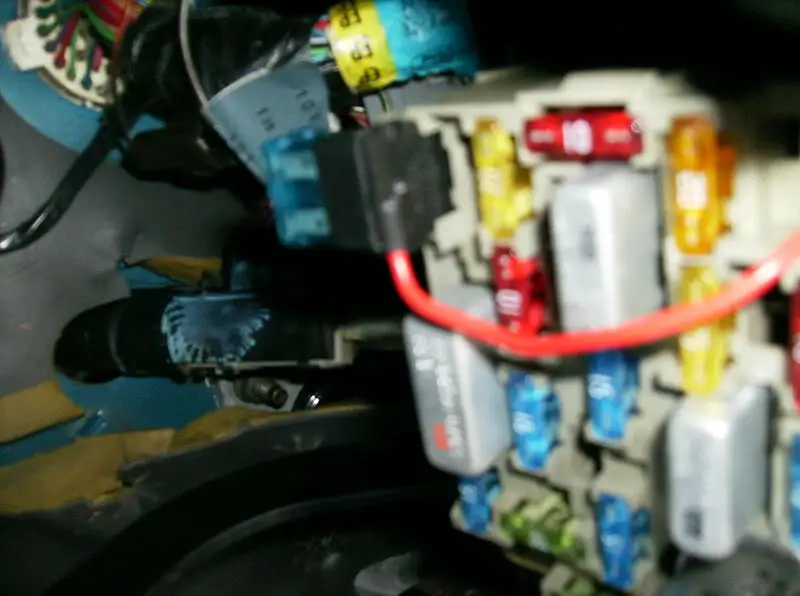

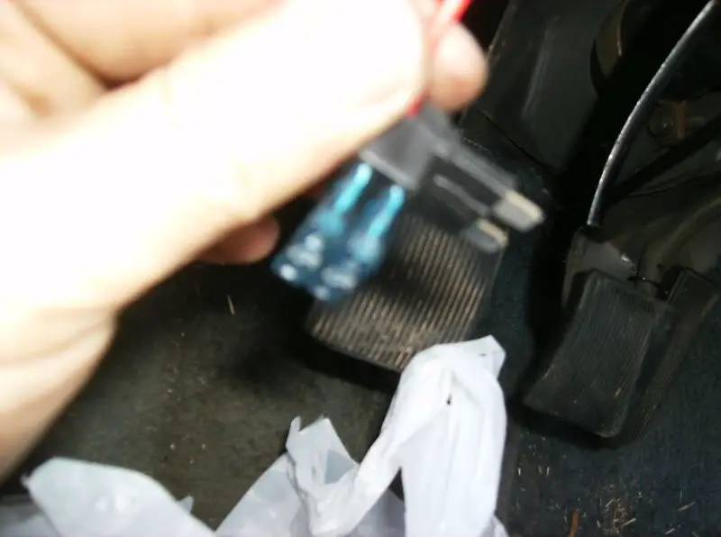

Then send the wire to the fusebox and wire it up to a fusetap device.

ah ok I was under the impression that they were all hot at al times.
