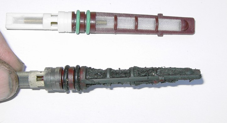

Here is that picture:
Thanks guys. I recognize the Black Death photo as this is pretty much what mine looked like when he replaced it on the first visit. Obviously this part has been replaced, but what causes the particles? The mechanic said it was from the compressor breaking down. My truck has 122k on it, and he did put in about a pound 2 years ago. This time round it seemed logical that it would need a pound added but that doesn't seem to be the fix.
Yeah Shamaal, I believe a low charge was the original culprit. His guage read the correct about of pressure, but it still wasn't working. I'm thinking his guages are off...I might go by there tomorrow and have him throw some more refrig in and check again for leaks. The bummer is that now I really need the AC. Crap...
In a residentail AC black death can also be the insulation around the wires in the compressor start breaking down and contanimate the whole system via the refregerant. I would suppose the same thing in an auto AC system. Generally the windings get too hot and that is what breaks down the wire insulation. I would use a gauge called a magnometer to help check the conditions of the windings.

Check this link. It has Shamaal's explaination of what causes black death: http://www.explorerforum.com/forums/showpost.php?p=1467296&postcount=9
This is a scary thought. Seems the best thing to do is replace every component. That would be crazy expensive I think. I think I'll go by a shop the specializes in AC today and see what they say. I'm in too deep now to just give up. 'sides, a summer without AC is nuts.
