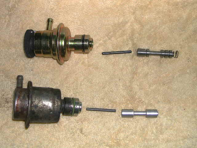

Be careful not to lose the pin in the modulator when you remove it. There are at least 3 types of modulators, so make sure you get the correct one. They use different hardware in front of it which goes into the transmission.
Here's a picture from Glacier991's photo gallery describing what I was talking about:

The modulator I had was like the bottom pic. I used water only because I was too lazy to go back to the store! I learned that 'cleaning' technique on another forum when I owned a Plymouth Laser. The quick and easy way to clean out the intake and combustion chamber was with water and to really do it, they suggested a can of Mopar Combustion Chamber Cleaner you get from the Chrysler dealers.
