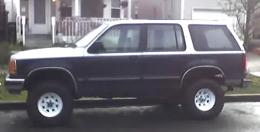

Pictures!
My garage is so small I cant get the whole truck in a picture. I will post some after I move it out front tomorrow morning.
I cant find the cable for my digital camera, so here are some crummy ones from my "camera" phone. Glad I didnt buy it for the camera feature.
