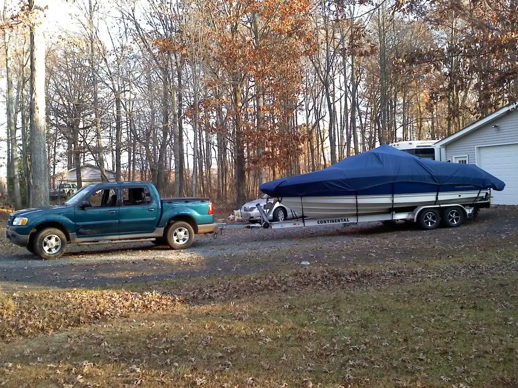

This is a 25' boat with a heavy tongue weight and overall weight of about 6500lbs. As you can see no sag and I had my MaxAirs pumped up to about 110psi.
