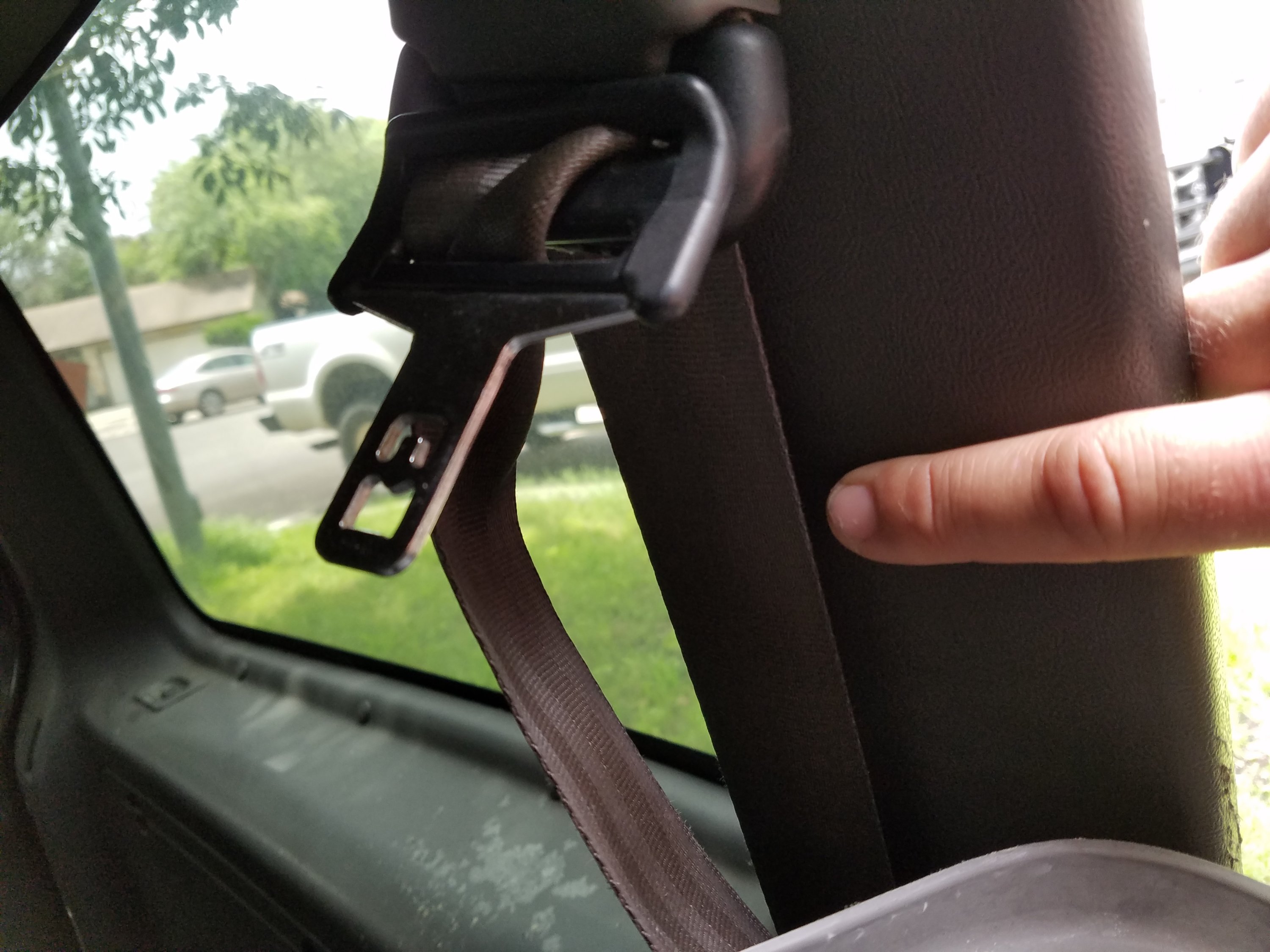

the speaker (it mounts in the driver side c pillar right below the seat belt anchor point)

This is where the speaker is behind the trim
This is where the speaker is behind the trimView attachment 90964
Wow, thanks for the info, I've been searching everywhere for it! I have everything except the speaker. So it plugs in behind the seat belt pillar on the drivers side rear seats? I found all of the other connectors so I imagine the speaker connector will be back there too.
Yes the speaker connecter will be there. It will be folded up and taped to another harness about 8 inches below the speaker mounting spot
That's the one. The connector will be a black square connector with two pins
