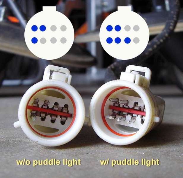

vroomzoomboom made me feel guilty so I went to the garage and pulled both mirrors to find out :p:.
As you can see, the connector w/o the puddle light only has 3 pins while the one with the puddle lights has 5 pins.

so what do you guys think? from what ive read (correct me if im wrong) it should plug in, i am somewhat handy so if they dont, i could probally make it work. or i could go to the dealer? i dont think my wallet can handle that lol
It should just plug in -- thats how it is with mine.
The white connectors are usually hanging beside the speakers so you'll have to temporarily remove those for installation.
ok thanks for the info. and install is as stated earlier? remove door panel, 3 screws and unplug old mirrors?
Yup yup!
you will have to run two wires from you conector to one of the interior lights i believe. if you only have 3 pins in the mirror connector, more then likely you will only have 3 pins in the factory connector in the door. or at least that was the case for my 98 sport
I have a sneaking suspicion that if the vehicle had puddle lights as an option, the wiring is there already. The mirrors will be plug and play. Do you see any signs IZ they added the extra wiring to the vehicle harness? Or did they just plug them in?
No signs of any wire modification.
