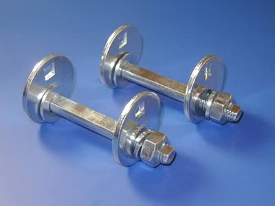

Alright, I bet you guys get a lot of questions partaining to this, but I jsut see few different "adjustable camber kits" or plates or cams, whatever. here's what I found:

Pic:

Buy the first one, the one from Summit thats round. I bought the cornered one before and had to buy the round ones soon after because the cornered ones didnt allow enough adjustment.

The stock "cams" (as the large washer-looking things are called) are not adjustable - neither is the A-arm itself. So the camber of a stock vehicle can not be adjusted.
Those adjustable camber "cams" are adjusted by rotating it. Basically you stick a 3/8" socket driver/handle into that square hole and rotate the cam until you get the proper camber. Then you tighten the nut down.
When the cam is rotated, it pushes the upper A-arm out (or in) therefore causing a change in the camber.

How it works -- notice the bolt hole is not at the center of the "cam". When the cam is rotated in such a way so that the opposite part part of the cam from where the bolt hole is, is aimed in towards the engine, the cam will be pushing against the inner tab on the chassis which will push the upper A-arm out. You'll see how it all goes together once the adjusters are on the vehicle.

Yep thats how you adjust it.

Alright, got one more question. Do I need to buy two of these kits? Cause I was told by someone to buy two. But don't I only need two of these? I believe that two come in a pack.
yeah you need two total - so if two came in a set, then you would need only one set. But call up Summit first before you order and make sure.

BTW, the stock camber adjustment is done with existing adjustable washers. There are eight washers on the two upper arms. The stock inner washers are shaped much like the "camber washers" to do exactly the same thing. The aftermarket washers replace stock round washers, to add to the adjustability.
I have just the four outer aftermarket camber washers on my 98. They came with the EE X-Spec kit. They work fine for minor lowering. Those kits that have bolts and all washers are evidently for more adjustment, for major lowering. I don't know exatly at what point of lowering that the other kit is better. Mine is lowered a couple of inches.
