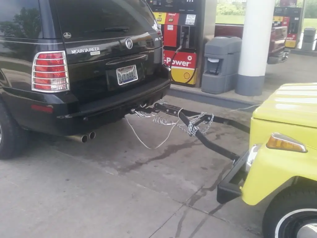

Well, I took the 14 hour trip up there and pulled this car all the way back 7 straight hours with no problems! The car hooked up to my hitch perfact! I averaged about 15mpg towing this car, so it dropped from 20.5 when I'm nto towing anything.
heres the pics of it...
