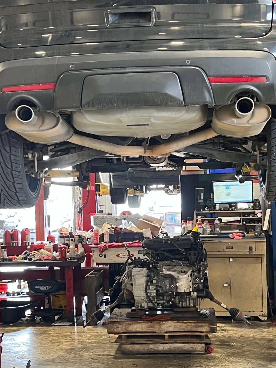

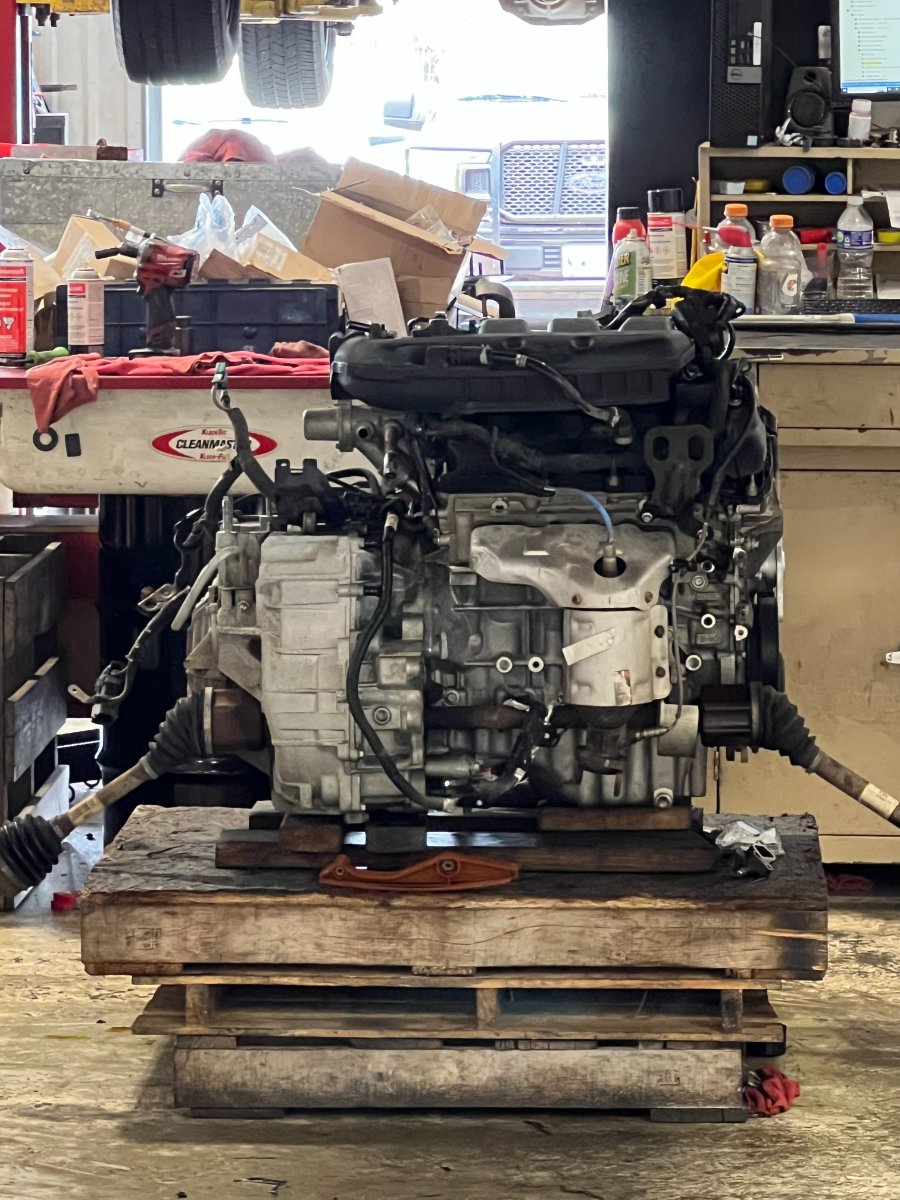

Well, like the title says....after 11 years and 180,107 miles later, I finally had to break down and get the water pump changed. A couple Thursdays ago right after the big Houston snow storm happened, I started to lose coolant in my overflow tank. I filled it back up, but the next day, it was gone again. I didn't notice and coolant anywhere on the engine, so I ran some coolant die through it to see if I could find anything. After a couple days (while checking the oil daily for milkyness), I finally found it coming out the water pump weep hole behind the alternator. So, off she went to my buddy at a Ford dealership to get a new life. Now, she's like new again :D I should be able to get another 100,000 out of her now.

:rolleyes: Interesting that they drop it all the way out, instead of the way most amateurs do. I wonder if that's actually quicker.
From what I've gathered from reading the threads on water pump replacements, dropping the engine is not a routine matter, even at the dealerships.
Peter
I do know the Ford Service manual states to "drop" the engine / trans for the water pump and also for a timing job.
I also know that the shop I use, doesn't drop the engine. Quicker not too.
