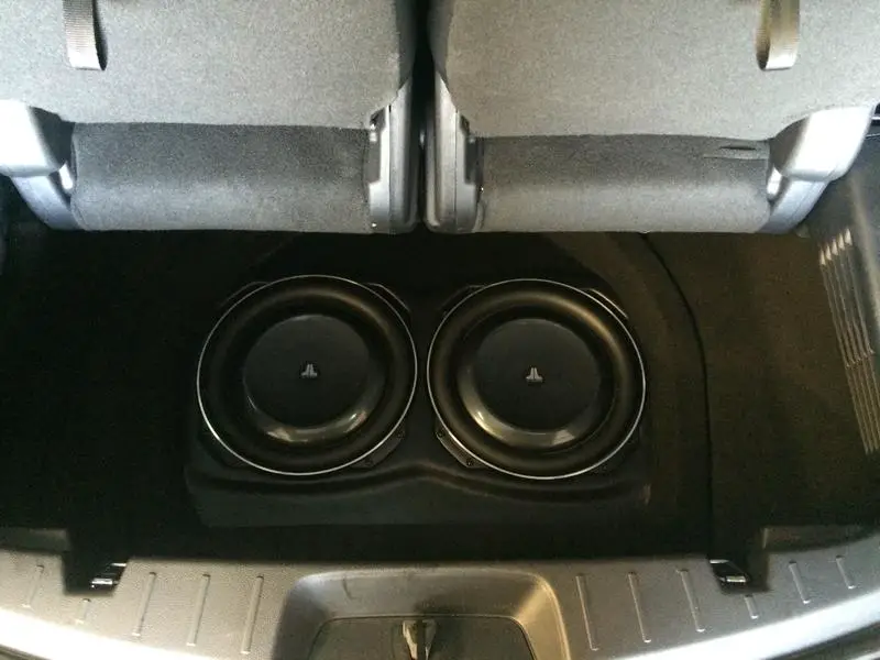

I just up-graded my audio 2016 Sport keeping the factory radio (Sony Premium).
Quick run down: I replaced the rear door speakers (powered from the radio)
Replaced the front component speakers (powered with a new amp)
Added two 13" JL Audio thin subs in a fiberglass box in the spare tire well.
I used a Bit 1 to interface the new amp to the factory speaker out-puts (after the stock amp). Even using the factory speaker locations the imaging is very good and sounds fantastic!
In the next few days I will post a complete run down on the system with some pictures (just remember I am OLD and shake a lot so they may not be that clear)

The interface that I think is the best for keeping the steering wheel controls is the iDatalink Maestro, if your new head unit supports it. I'm using the Ford Sync with my touch and the Bit 1 and I think it sounds better than 99% of the after market head units.
