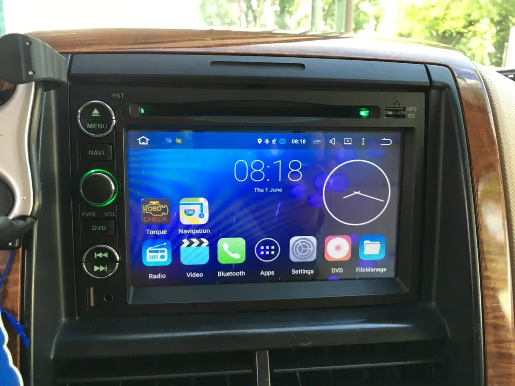

The front main menu

The front main menu
